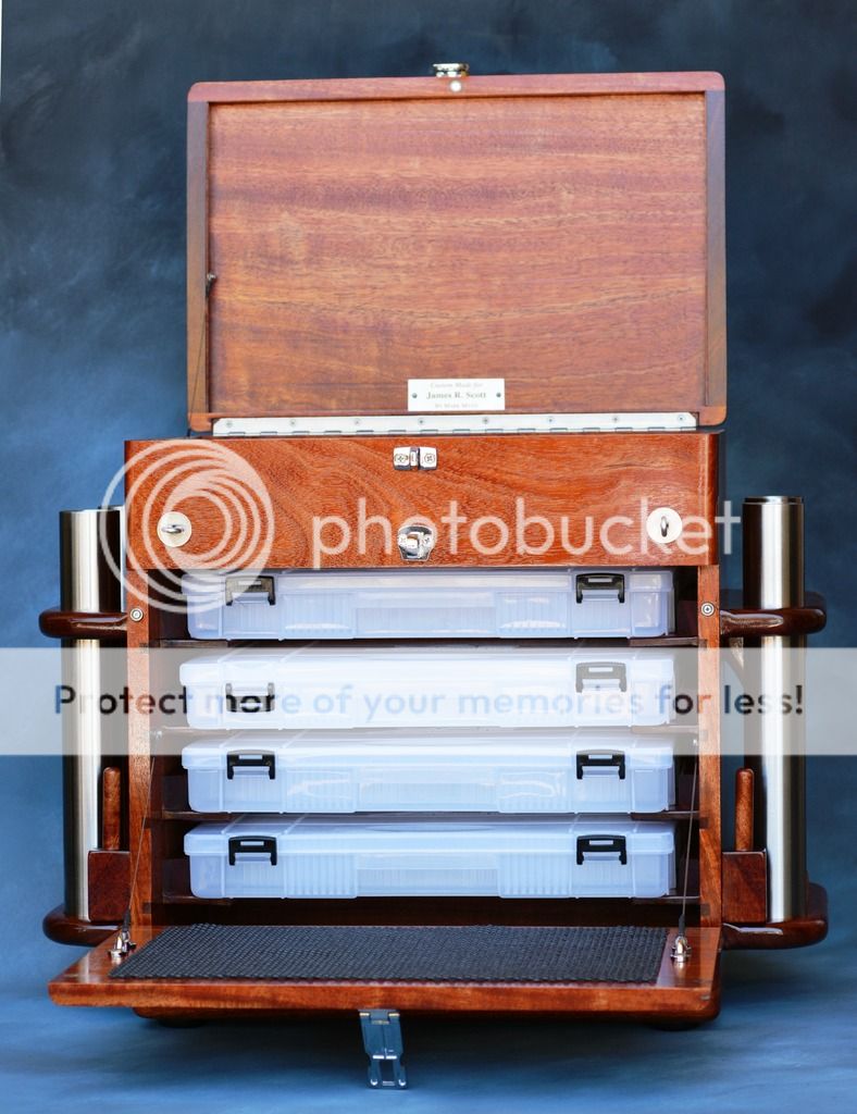

Custom Long Range Fishing Tackle Boxes
Handcrafted from a solid piece of African mahogany
(other fine hardwoods by request and will probably add to the price)
Stainless steel hardware - screws, bolts, eyes, hinges
Marine grade Perco hasps and latches
Hand - rubbed System III spar varnish finish (4 -6 coats)
Space for 4 - 3700 or 3600 size premium tackle trays (4 included)
Upper and lower storage space for pliers, cameras & odd shaped items
Anti - skid black liner covers top, lower storage areas and inside door
4 - stainless steel rocket launchers for rods/reels on series 7;
3 -stainless steel rocket launchers for rods/reels on series 6
Integrated side handles
2 - hook eyes - used to tie hooks tightly
2 - line pullers & holders - (these protect your hands from line cuts)
Series 7- H 17.5" x W 22" x D 11" Series 6- H 16" x W 12.6" x D 9"
new Series 7 Weighs about 18-20 pounds - Series 6 Weighs around 12 pounds
new Series 7 = $850 - Series 6 = $800
That is some superb work, and thank you for all the specifications. Ill be honest in telling you that they are a little out of my price range...but every bit the value with all of the workmanship and material that goes into them. Anyone could be more then proud to own one, I wish I were one myself.

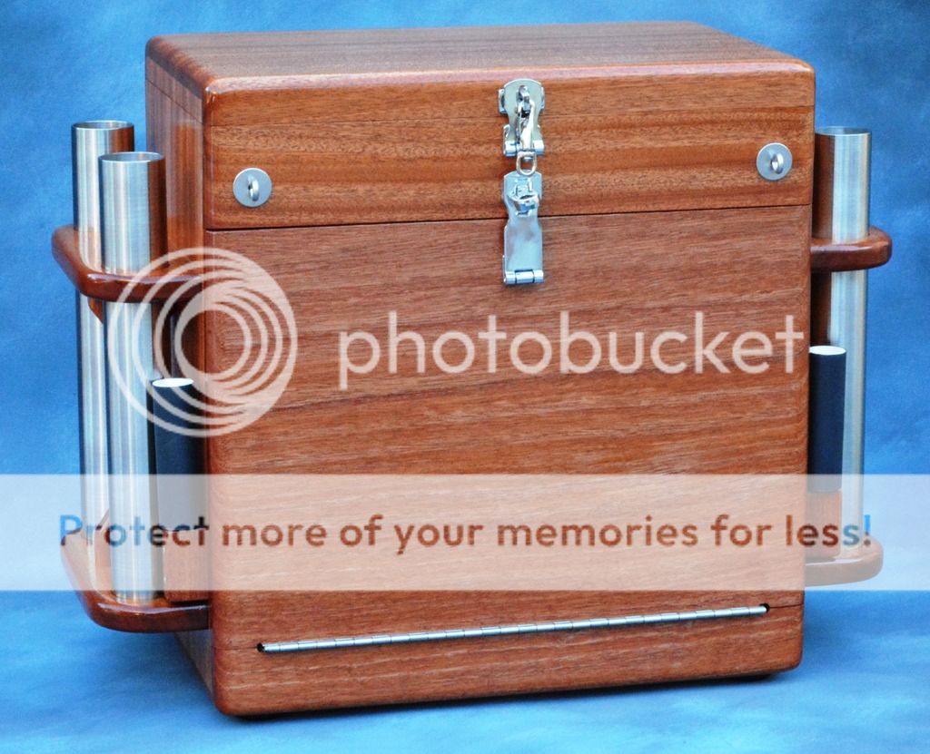

A new one for Jon Maita from New Jersey.
Rancanfish

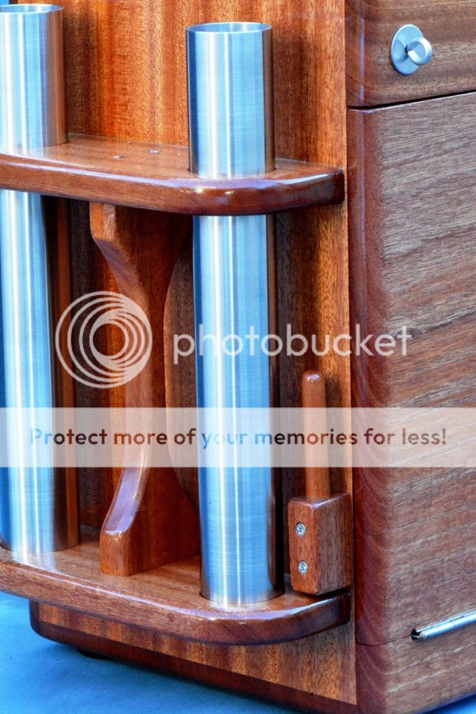

I am in awe of your craftsmanship. One thing I don't do at all is work with wood.
I once bought 30' feet of trim to install on a fireplace mantle project, that required 9' feet.  I couldn't get the angles right,....over and over.  And it had to be perfect before I could stop.
Your finishes look nicer than the finish Martin guitar craftsman put on my Martin mahogany guitar, but of course they don't want a thick finish for sonic purposes.
I'm still confused on the small dowel on the side? Line puller you referred to?
And the hardware on one of the boxes looks like the latch on one of my Boston Whaler compartments.  You don't scrimp obviously.
Again, just beautiful.
mmayo

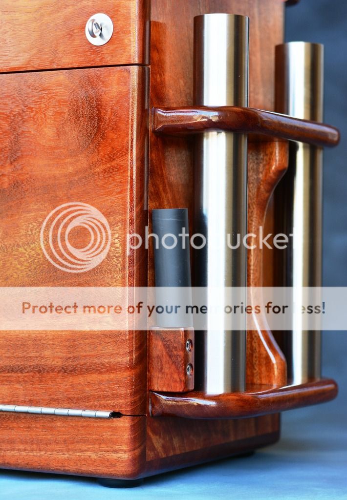

The small dowel holds a line puller shown below.  These homemade devices have allowed me to fish a ten day trip without zero line line cuts!
I make them by using heat shrink tubing around PVC pipe.  Be sure to never wind line on top of other line to prevent damaging your line.  Note indentations that would have been line cuts in my fingers.  They win against spectra and allow very tight knots.

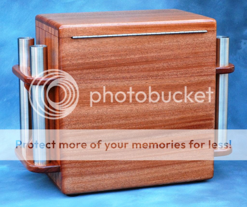

This one was built for Rudy Scott. It has amazing color and grain structure.
Mark, I could see you put a lot of heart into your work, beautiful job...as always.
Quote from: Alto Mare on July 24, 2015, 02:04:19 AM
Yep and a lot of heartwood.  Dominick
