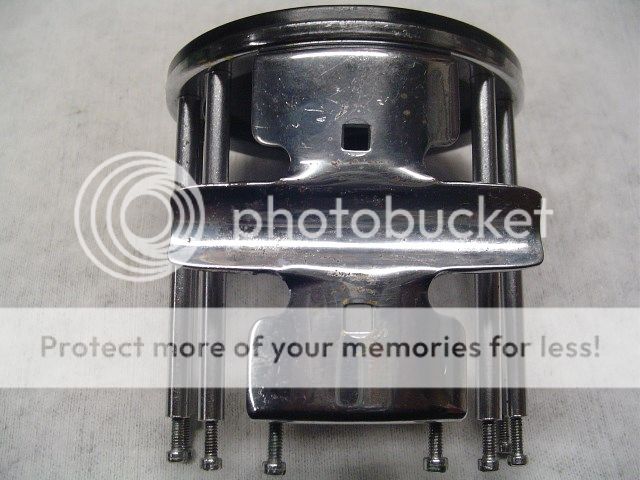

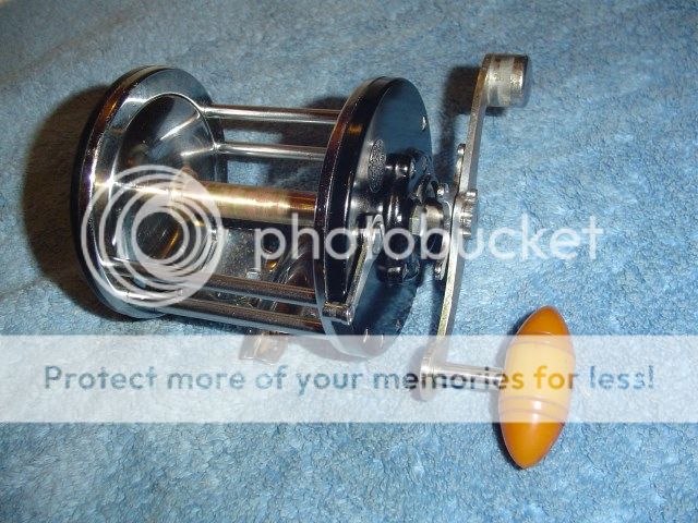

I put all the parts from this old reel in some simple green overnight and got back at it this evening.
I got them Clean enough to sit on the Table without any rags, so That is a first. ;)
I left some of the original patina, just trying to make this Dinosaur show quality. No Dremel or sandpaper, just some paper towels, simple green and chrome polish.
Almost finished, Seventy year old reels are a lot of work. ::)
I intended on keeping the drag stack original, but I guess after they sat out overnight, they crumbled when I picked them back up to put some grease on them. Put in 6-60's. I am very Happy with the results.

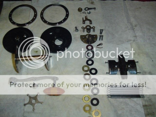

I did my old pre-war Penn 68 today, These are very hard to come by. The #68 model was introduced in 1942 and the production run was cut short by the War Act. The particular reel I have has been around the block, so all parts I feel are not 1942, especially the handle, it think it is older.
Here are all the parts, I left all drags original because they were in nice shape and were still soft. I believe they are leather.
        As I said, the reel was very used, so when I cleaned the spool, all of the plating on the spindle was gone. Strangely enough, the spool sides were still in very nice shape.

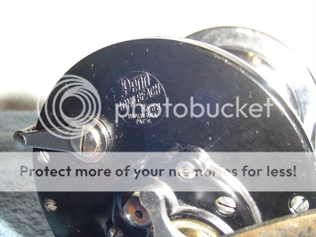

        Can't miss the classic picture tail plate. The Model 68's had Hershey Kiss style clicker buttons. The early Model 66 and 67's had the waffle style clicker and the first model 66 even predates the picture plate and has a blank tail plate.
        Because my reel is early, nothing has a part number. Even all internal parts are not stamped with part numbers.
        I have not seen a Penn 68 that was not identified with the model number. Earlier model 67 and 66 had head plate logo that only stated Penn Long Beach. Of course, everything is interchangeable, so a non-marked Penn 66 or 67 side plate could be used to build a model 68. Stranger things have happened..............<:O)
        I like this reel, it is a small game big game reel. Even in the factory stock configuration it has a five disc drag and steel gears, it is a strong Long Beach.
        I believe the handle on this reel is a very early Penn 49 handle and I think the Penn 49 handle upgrade is the perfect touch for one of these Model 68's. They even feel more right than the stock handle.
             So there is one of my oldies. I make no claims that this reel I have pictured here is 100% historically correct. I guess by the time any machine gets used for 70 years, something had to be changed on it. By the way, after cleaning and reassembly, this reel and drives runs like new.
