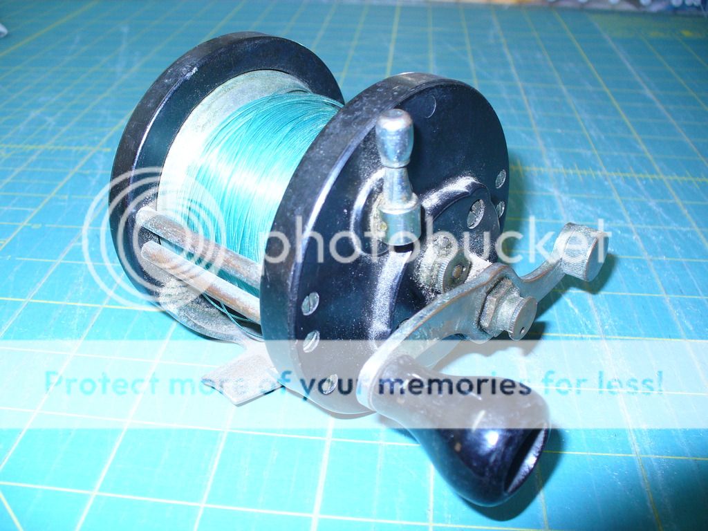

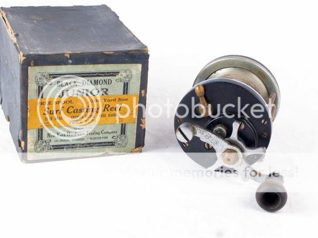

I've never had an Ocean City reel, so, when I found these two examples, I had to have them.  They are both identical in size to a Penn Long Beach 60.  They are also trade reels with the New York Hardware Trading Co logo.
The first one has three pillars and a star drag.  The reel foot is marked:
                                             BLACK DIAMOND JUNIOR
                                                        250 YDS
                                   NEW YORK HARDWARE TRADING CO
                                          LOS ANGELES - PASADENA
It has the diamond inlay of the NYHTC on the tail plate:

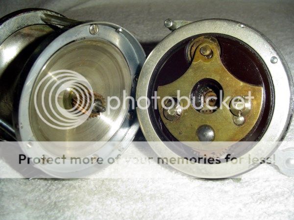

It is interesting to see how it differs internally from a Penn.  For those who aren't familiar with OC reels, on this model the main gear moves vertically to disengage from the pinion, unlike a Penn where the pinion moves horizontally to disengage from the spool.  Also, the drag stack is a 2+1 configuration but seems to function as a 1+1.  I suppose this is adequate on a LB 60 size reel.  One other thing, the dog spring has a 90 degree twist on the end and doesn't effectively make contact with the dog, rendering it useless.  Or, is the dog spring correct and am I assembling it wrong?

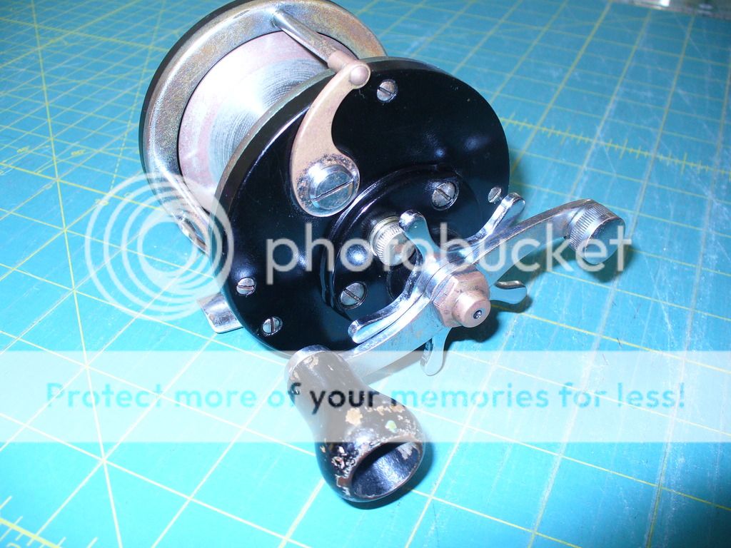

The other reel doesn't have a star drag and reminds me of an old Penn 80 Conventional in size and function.
                                              BLACK DIAMOND SPECIAL
                                                         250 YDS
It also has the NYHTC diamond logo on the tail plate:
Michael, I think it strongly resembles your photo and description of the Seal Beach 136.

You are correct about the Seal Beach model. The other reel is a early, circa 1931 Bay City model.

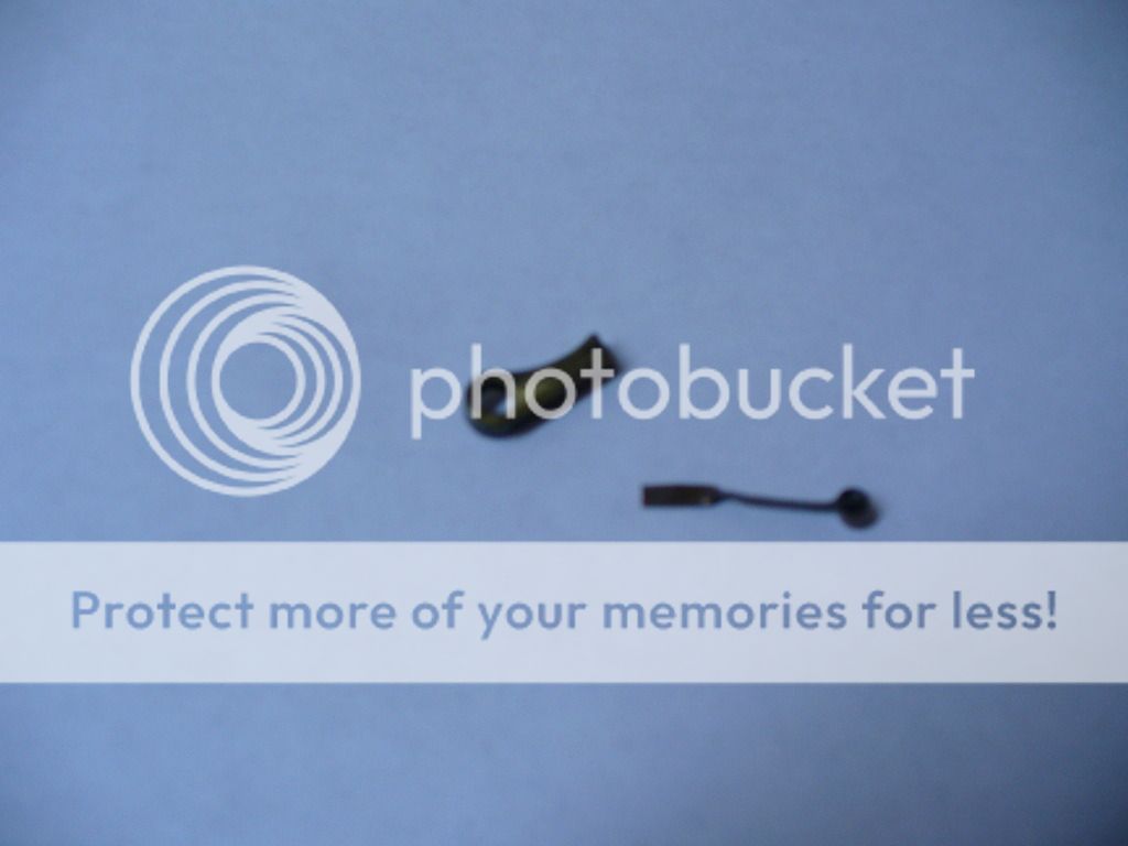

Internally should be relatively simple. I would think the anti-reverse dog spring is a simple bent left spring, unless your reel is a left hand model, the spring gets weird.

Quote from: Penn Chronology on July 12, 2016, 07:15:18 AM
George,
Internally should be relatively simple. I would thin the anti-reverse dog spring is a simple bent left spring, unless your reel is a left hand model, the spring gets weird.
I only have a assembled bridge picture of the insides of the 1931 model.
I expect this is the bridge in your reel. It is a pivoting bridge, which moves the main gear away from the pinion. I would think the anti-reverse dog travels with the bridge; but, I could be wrong. It has been a long time since I was inside one of these. It looks to me that the dog spring on your reel is straightened out, cannot really tell though, On a right hand drive reel the dog should be riding on the upper portion of the dog gear. If the reel is left hand drive, the dog is sprung up into the dog gear from the bottom of the gear. Weird ::) Depending on how the reel is driven will also dictate how the dog spring is shaped. Hope this helps, rather than confuses things..............<:O(
Michael, you're photo is identical to my bridge.  I will straighten the dog spring, reinstall it, and see how it works.

I just finished cleaning up the Seal Beach and took a photo of the tail plates of both reels.  Notice the placement of the diamond inlays.
Here is a photo of one of Michael's (aka Penn Chronology) reels.  I borrowed this photo from one of his posts on "Show off Your Long Beach".
I'm surprised that the diamond inlays aren't placed in a standardized position.  They're all over the place. ???
viurem lliures o morirem
#71
These are great Trade Reels. Production Number are impossible; but, you really do not see too many of these around today.
I have a 1934 Penn Bridge City with the Diamond logo on the tail plate. New York Hardware Trading Company was not an Ocean City Exclusive. :)
I do not think the markings are inlaid. My Penn Bridge City looks like a paint stamp marking. It is a very durable mark. They do not come off...
Wish this one was mine. It is out there somewhere!
George4741
Mike, as you know, your third photo in the previous post is the head plate view of the OC reel shown below.  I assumed that it was your reel.  I stand corrected.
Quote from: George4741 on July 12, 2016, 08:22:03 AM
After careful examination, I'm sure the diamond on my Bay City is an inlay.  I'm not so sure of the diamond on the Seal Beach.
QuoteAfter careful examination, I'm sure the diamond on my Bay City is an inlay.  I'm not so sure of the diamond on the Seal Beach
The Bay City is an older reel than the Seal Beach or my Penn Bridge City for that matter. Being that it is older may explain why its diamond is inlaid. Also the Bay City is a more expensive reel than the Seal Beach or Penn Bridge City. I have never seen one that was a real inlay. I have owned a couple of these. Sold them all except the Bridge City, all of mine were not inlaid, although you have to look close. It is not easy to tell the difference.
