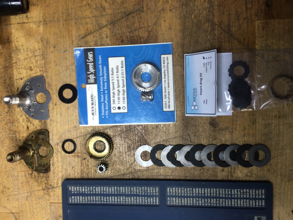

Bridge arrived in today's mail, so here's what were tossing aside and replacing in this reel.
On the left we have the old and on the right the new.
1st up is the old brass single dog bridge and original brass sleeve with hard fiber washer, it will be replaced by the long awaited pro challenger bridge with 10 tooth sleeve and delrin under gear washer from Adams insert kit.
2nd the old brass main gear will be upgraded with an original accurate 4:1 stainless steel maingear and pinion courtesy of Broadway.
3rd.  This reel had an upgraded 5+1 drag Kit, but Adams insert will boost even those numbers so that's the way we're going.

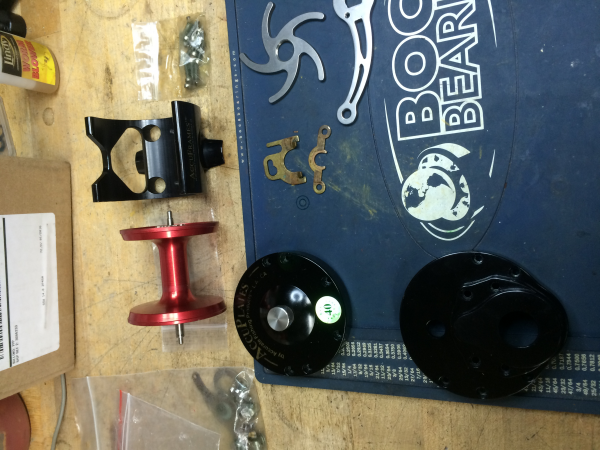

Let's look at the rest of the parts.
We start with accurate magnum sideplates, bearings opened cleaned and lubed with tsi321.
An immaculate accurate 99 frame, I had to purchase a whole jigmaster reel to get this but it was worth it.  The reel itself had never been spooled so now I have the frame to use on my magnum reel and a virtually brand new set of jigmaster sideplates for future use.  And then there is the spool, the unicorn of the magnum reel world.  So hard to find in any color or size. to try and find a red 99 size was at times frustrating, but persistence and patience  paid off and I was able to procure this very clean red 99 magnum spool.

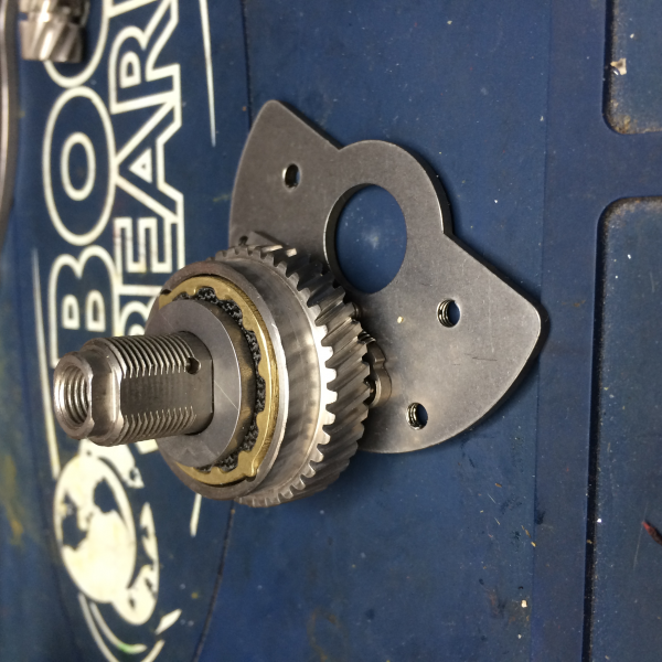

Here's the new bridge and gear stack with insert all dry fit.

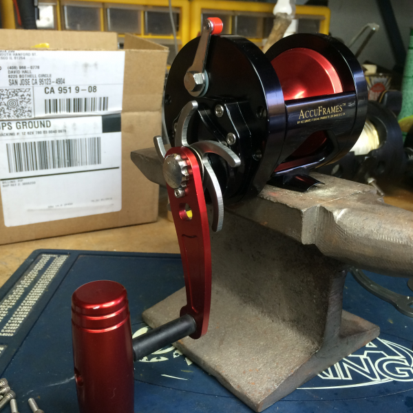

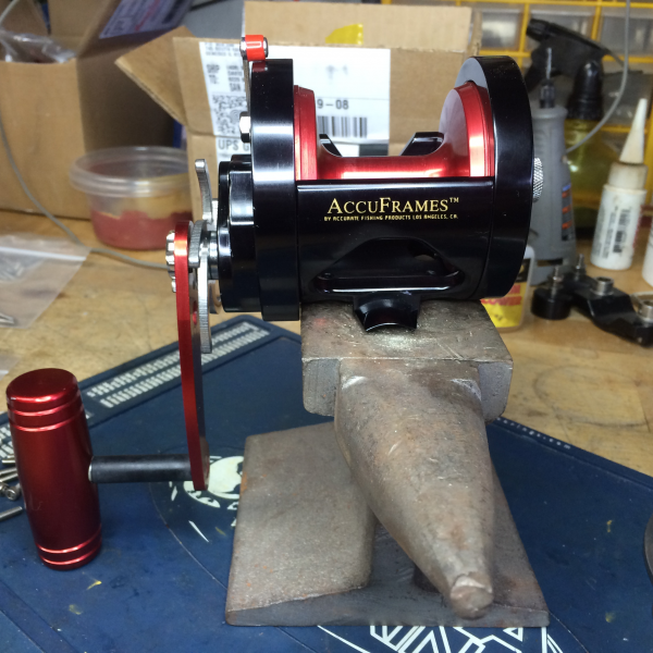

Scavanged an eccentric spring from an unused side plate and got the side plate together. Toms bridge screws fit perfectly.  The bridge itself fit right in with zero tuning, no mods whatsoever, but Toms frame screws don't fit through the holes in the side plates so I had to use stock slot head screws for now.  The bridge screws protruded through and stick up a little bit.  I assembled the left side plate to the frame, installed the spool then the right side plate, nested right snug and tightened it up to the frame, no problems shifting in and out of freespool, the new 10 tooth sleeve is awesome practically eliminates backlash in the handle.  Added Adams star and a temporary arm and handle to match.  The spool is slightly off centre as Mike has indicated and it appears the problem is the same, the drive side bearing cup needs to be milled a few thousandths deeper to get the spool to move slightly right.  There's no line eating gaps so I may or may not do anything about it.  I think it came out looking like I planned and once I get my Motive Fab counterbalanced arm polished up and one of Lou's knobs, I can call this one done except it's all dry fit right now and everything needs grease and oil.

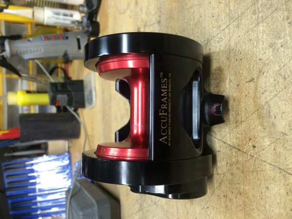

Another view, note:  not shown here is Toms knurled adjustable bearing cup, it is installed, fits perfect and works fantastic.
