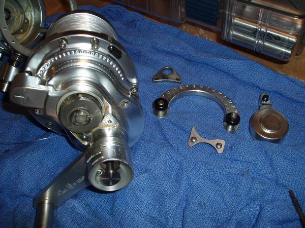

pulling the frame off the side plate is easy, just 5 screws (key # 93).
next, remove the preset arm (key #18), the preset arm support (key #24),
remove the spool shaft retainer g/s (key #26), do not disturb or change the orientation of the main lever arm assembly.
