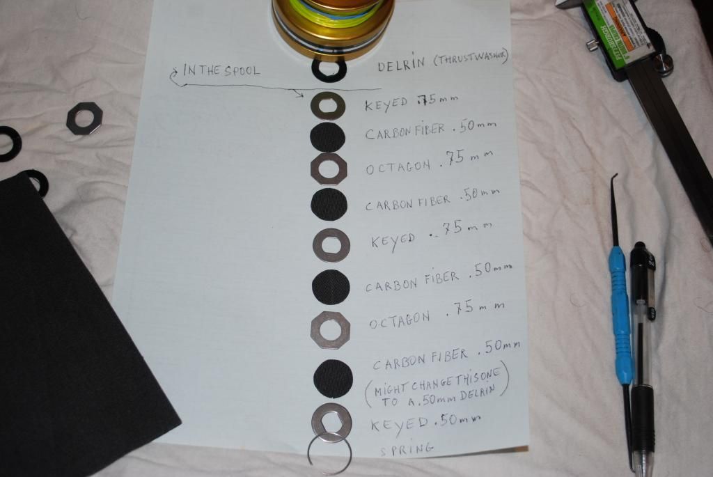

Hey guys a couple of Spinfisher questions. I have a Penn 8500SS. Inside the spool was a drag stack that consisted of both CF and Teflon washers. The Teflon was on the bottom. I replaced the Teflon washer with a 6-60 CF washer. The drag stack feels a bit tighter in the spool but it fits. Are you guys replacing the Teflon washer with CF?

I replaced the Teflon washer with a delrin which I'm doing with all my reels. It seems to make them smoother at higher drag settings. The rotors seem to wobble a bit on all my SS series when I just spin them. I don't notice it when I am reeling in a fish. Maybe the tension on the roller offsets it. ???

Wallace came up with a killer set up on modifying the drag stack on these.
Here is the thread.
http://alantani.com/index.php?topic=12413.msg122210#msg122210

Every time one comes across the bench I toss the Teflon washers and add another HT-100. I have never noticed and change when installing.

Thanks Keith. I have it all put back together now and it feels really smooth.

If you're talking about the washer in the spool, I agree, but if you're talking about the thrust washer, I disagree.
Under fishing conditions you should notice that the Delrin washer is a better choice there.
FatTuna
Sal which one is the thrust washer?
The thrust washer is under the spool.
