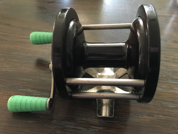

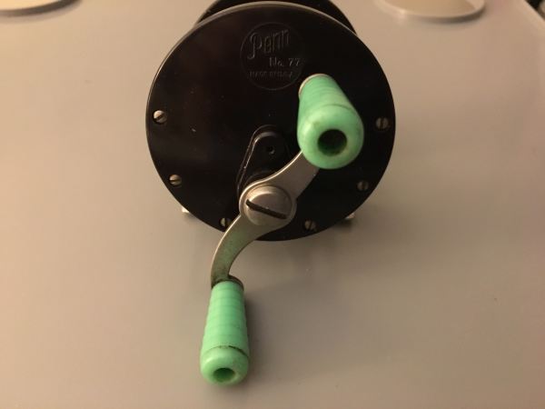

#1901
A Genuine Penn model 77 that you can't double dog, change the drag stack, nor add any stainless steel internals !
Appropriate for catching the large minnows and other mini fish !
#1902
Looks like it is in great shap,,,,, :D and is overlooked by most great find,,,,, ;D
A great find ! If all the fish that were caught on those 77's were in one live well...it'd have to be a BIG boat !!! It's surprising the fish you can "handle", by "thumbing", and "back reeling"!
