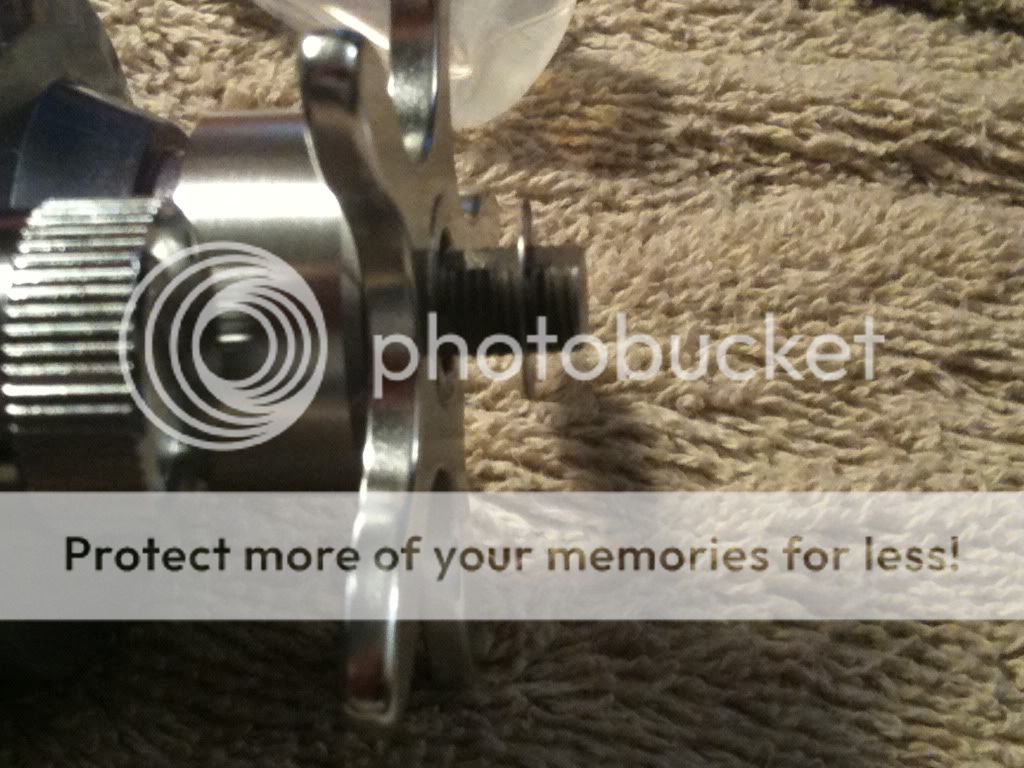

you guys are really gonna hate me for this.
the revo has a stainless steel ratched gear that bangs up against the kick lever when you turn the handle. this kick lever then pushes to thumb bar up and clicks the reel back into gear. the kick lever is made of a softer alloy. it's some type of pot metal. it is not cast surgical grade 316 stainless steel. that's what it has to be made out of. and it's not. so what is happening is that the top of the kick lever is eventually worn away. now suddenly the reel will not go back into gear. ambassaduer apparently has recognized this problem and has placed a stainless steel insert into the kick lever. this will take care of the problem.
the only issue remaining is to identify those reels that have a kick lever with a stainless steel insert, and those that do not. i know i've missed a couple of staff meetings, but i have not heard of this being discussed prior. here are the photos.
here's the ratched gear and kick lever. see how the kick lever is worn away?
the corner is completely gone!
it's not hard to change. you have to remove the two screws that hold the jack plate and hope those two springs don't take flight.
here's another one with the same problem.
this may help someone identify the reel if needed in the future.
here's the worn kick lever.
ok, so what i did was i had these reels to fix back in april and called ambassaduer for 2 months looking for replacement kick levers. they kept on saying that they were on back order, first until june, then july. the last time i called, the nice lady at ambassaduer decided to connect me to the service department for some unknown reason. i spoke to a guy there named sonny. i explained my problem, didn't tell him who i was or where i was, just told him that i had two reels with the same problem and i had them cracked open and was waiting for parts. so get this. the guy says that he will pull apart two reels and give me the kick levers out of these reels. that's right. he did just that and they arrive 5 days later. no charge, but, um, also no real explanation.
so here's where i'm at right now. first, the original revos apparently have a kick lever that is made of a softer metal alloy and a hard stainless steel ratchet gear underneath the main gear. in at least two reels that i've seen, the kick lever was chewed up. ambassaduer must be aware of this issue because they send me a kick lever with a stainless steel insert that i believe will totally eliminate this problem. second, in my conversations with abu, i made a friend and his name is sonny. and now i'm going to kick him in the teeth after he did me a favor and i'm going to post a problem about his reels. look guys, i feel really bad about this, but you have to know. maybe i missed it, but did ambassaduer come out with a service advisory telling people that there was a problem with the revos? if they didn't, it might be a good idea, but far be it from me to tell a reel company what to do with their own reels.........

call ambassaduer at 800-228-4272 and ask the nice lady for a kick lever for your revo.  tell her you need the new kick lever with the stainless steel insert.  if she says that she does not have one, ask to speak to sonny. if sonny says that he does not have one, or if they refuse to transfer you, then ask for a plain kick lever.  if they tell you that they do not have any, then you are screwed. let me know and we will see about a modification that might work.  we may have to start making them ourselves.  alan
Quote from: Master Chief;1983035Here is the new part #? This is the reply.
"Chad,
I spoke to our reel technician and got the part number for the new kick lever.
The part number is 1156749 and they are available for $2.50 each plus s&h.
You may order parts direct with credit card at 1-800-228-4272..
Thank you,
Nissa Lundquist
Reel Service Representative
Pure Fishing Inc.
a subsidiary of JARDEN Corp."
Hope this helps......
thank you, master chief. i just called and ordered 10. the total came out to $34. good thing. i have another revo headed my way with the same problem. alan
