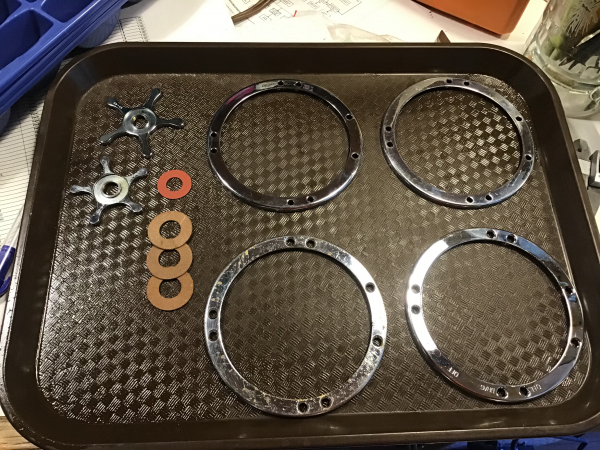

If any of this would help you, Crow —
(4) rings — 3 new, one in lower left used
(3) new leather drag washers
(1) fiber under gear washer
(1) 49 star marked 10-49
(1) 10-60 star marked as such
I could also send you all (21) screws, if you wish (head plate and stand, tail plate and stand, bridge screws, and handle lock screw).
Let me know, if any of this works for you — N/C as long as you can use the parts on the reel.
Good to know AC. That may help someone from pulling the hair out of their head.
