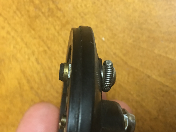

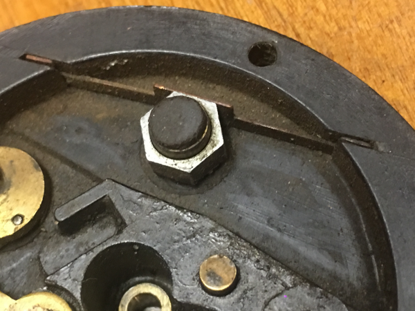

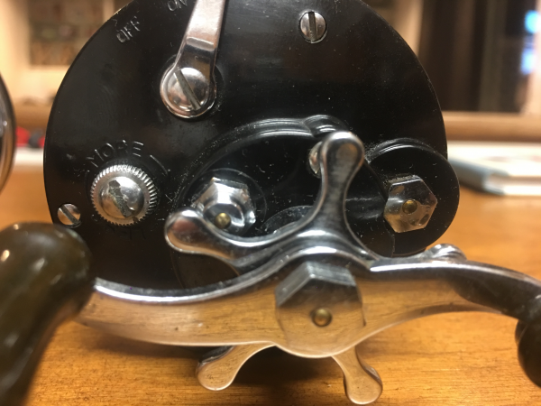

Here's a pair of 1942 first year 109 reels. 1942 was the only year the reels had the anti-backlash control. Knob is adjustable and located on the head plate.
xjchad
Nice reels Chris!  I love the handles!
Didn't know they ever had any type of backlash control, I'd love to see the inner workings of that!
Husband, Father, Fisherman
Chad the adjustment screw pushes in and out on this (felt?rubber?) knob, which rubs the inside of the plastic spool. This causes constant friction. I can see why it was discontinued.

That is an interesting casting control. Good score on that pair !
