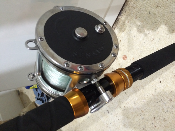

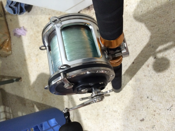

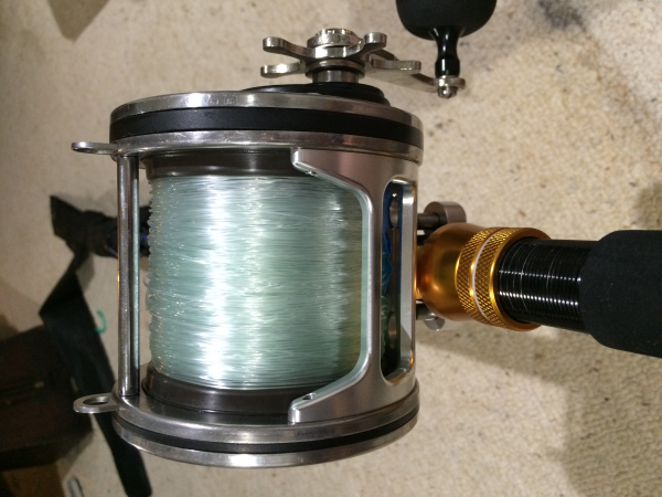

Well I'm getting ready to head to do some land based sharking in Ft Morgan area this next week. So naturally I had to do some hotrodding to my penns.
I scored a silver Dom/Tom frame from Aiala. Upgraded both reels with ss gear sleeves and double ss dogs from Bryan Young. Pro Challenger gears in the 115L, ss yoke from Dawn and Bryan's 7 stack drag set. The 114h is a full frame model and was like new when I picked up for $75. It already had a new unused HT-100 kit so I left it alone for the time being. The 114H also received a factory steel main gear I had laying around. Mounted both on a pair of Davis Biggame 80-100lb class rods. Spooled the 114h up with 550 yards of 80lb spectra braid/175 yards of hi-seas 80lb mono topshot and the 115L got 700 yards of 100lb spectra braid/200 yards of 100lb hi-seas grand slam mono topshot. Hope to put some shark on the sand this next week. Thanks to Daron for some guidance!

J,
I just noticed. In two of those pics, you have the high bar in front. In one, you have the high bar in back. It doesn't really matter, but the High bar is intended to be in front based on the Accurate design.

jhatch
Quote from: Shark Hunter on June 02, 2016, 05:48:14 AM
J,
Daron, its in the front its just the way I took the photos. As a matter of fact the when the line is very low on the spool it touches that front bar its so high. lol hopefully I wont get spooled that far though. lol

Quote from: erikpowell on June 02, 2016, 10:30:20 AM
pssst.. have a closer look bro  ;)
Ahh,
The middle pick, the rod is facing down. That is what happens when you are on your 6th Tall Boy. ;D
