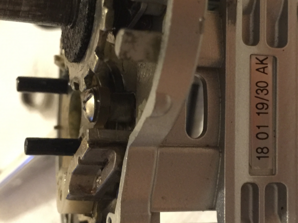

Hi guys,
I have a revo toro 50 that I've caught a bunch of tuna on. Last season, i started getting this issue: when line is peeling off too quickly, like after a tuna bite, I turn the handle and the reel doesn't fully engage and I get a loud ratcheting sound from it not fully engaging. I can eventually get it to engage by giving it a little slack and then turn the handle some more
Does anyone know what's wrong and how I can fix it?
Thanks!

Pianoman
Ah forgot about the kick lever. Thanks Alan!
Cracked the reel open to take a look and it actually looks like it's held up pretty well over the years. Mine has the stainless insert.
I think the issue is the dog not catching when I put the reel in gear because it's spinning too fast when a faster fish takes the bait. I think the dog just knocks on the edges of the ratchet until I give it some slack to slow it down to catch. I tried pinching the ears together but can still replicate the problem.
Any ideas? Would a new dog help? I have a new nacl that doesn't have this problem but haven't fished it yet.
Thanks!

johndtuttle
Quote from: Pianoman on July 02, 2016, 04:40:37 AM
Thanks!
Depending on the Revo model it may also have a free floating pinion gear. Abu calls this "Infinii Spool" and Penn calls it "Live Spindle" and Daiwa has another name for it...(I think it was Daiwa's innovation originally but I may be wrong)...anyways...the Pinion fully disengages from the Spool Shaft and so the reel doesn't like to go in gear when the spool is spinning or under load. The only way to get them in gear if a fish is running with the bait is to slow the spool with your thumb....
This is a trade off of the otherwise superior casting performance of this design.
