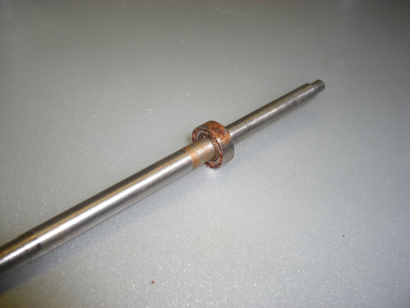

I have a reel that had a badly corroded bearing seized onto the spool shaft. It's a Senator 114H. I was trying to pull it off with a pair of vice grips. When I applied pressure, the bearing literally exploded in to pieces. The inner part of the bearing still remains on the shaft. It's really stuck on there. Any ideas?
Nothing magic, but a long (overnight) soak in penetrating oil might help. Also cycling between hot and cold can take advantage of the different coefficients of thermal expansion of the different metals, that might free it up. Last ditch effort would be to grind carefully with a dremel.

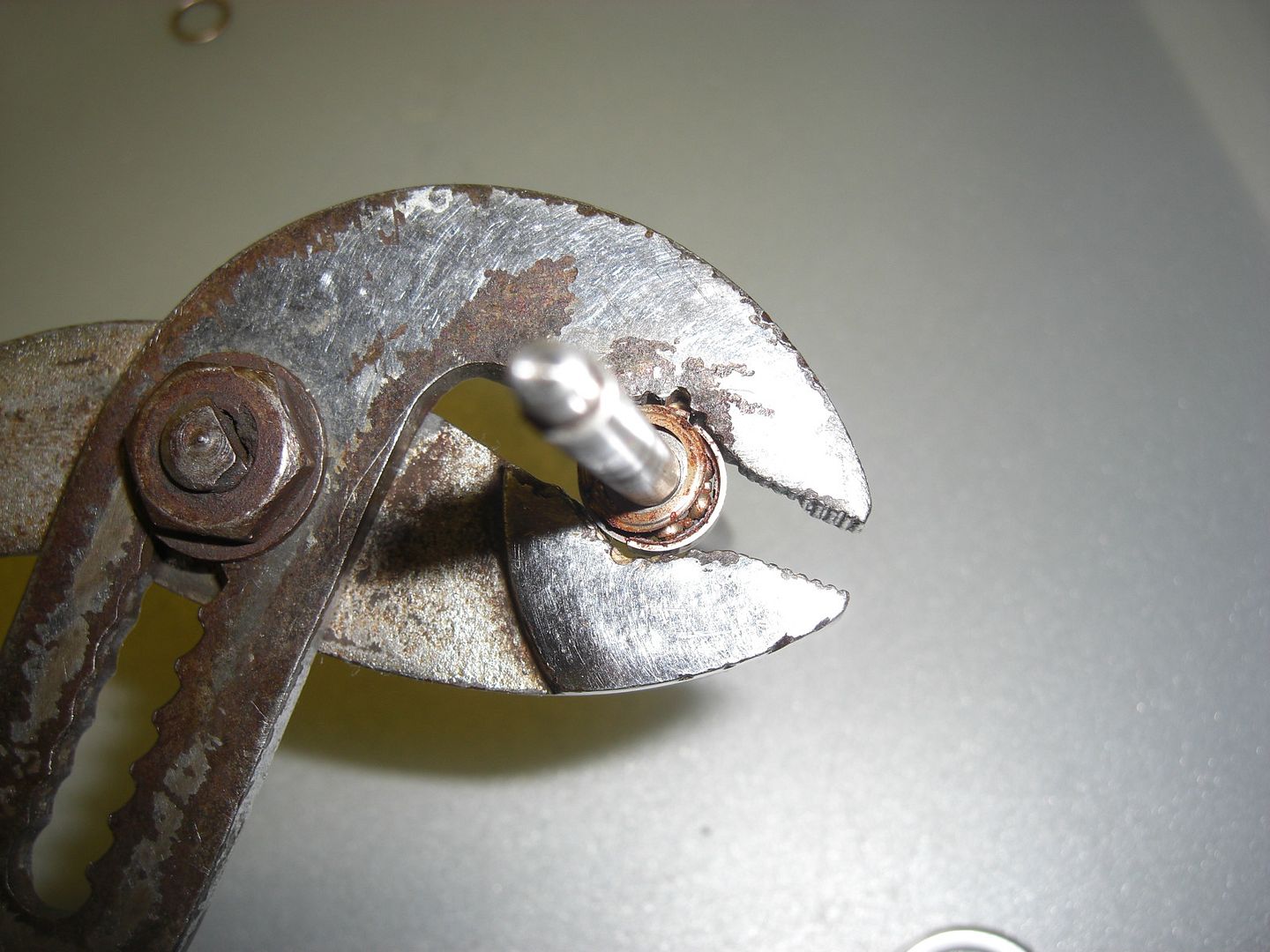

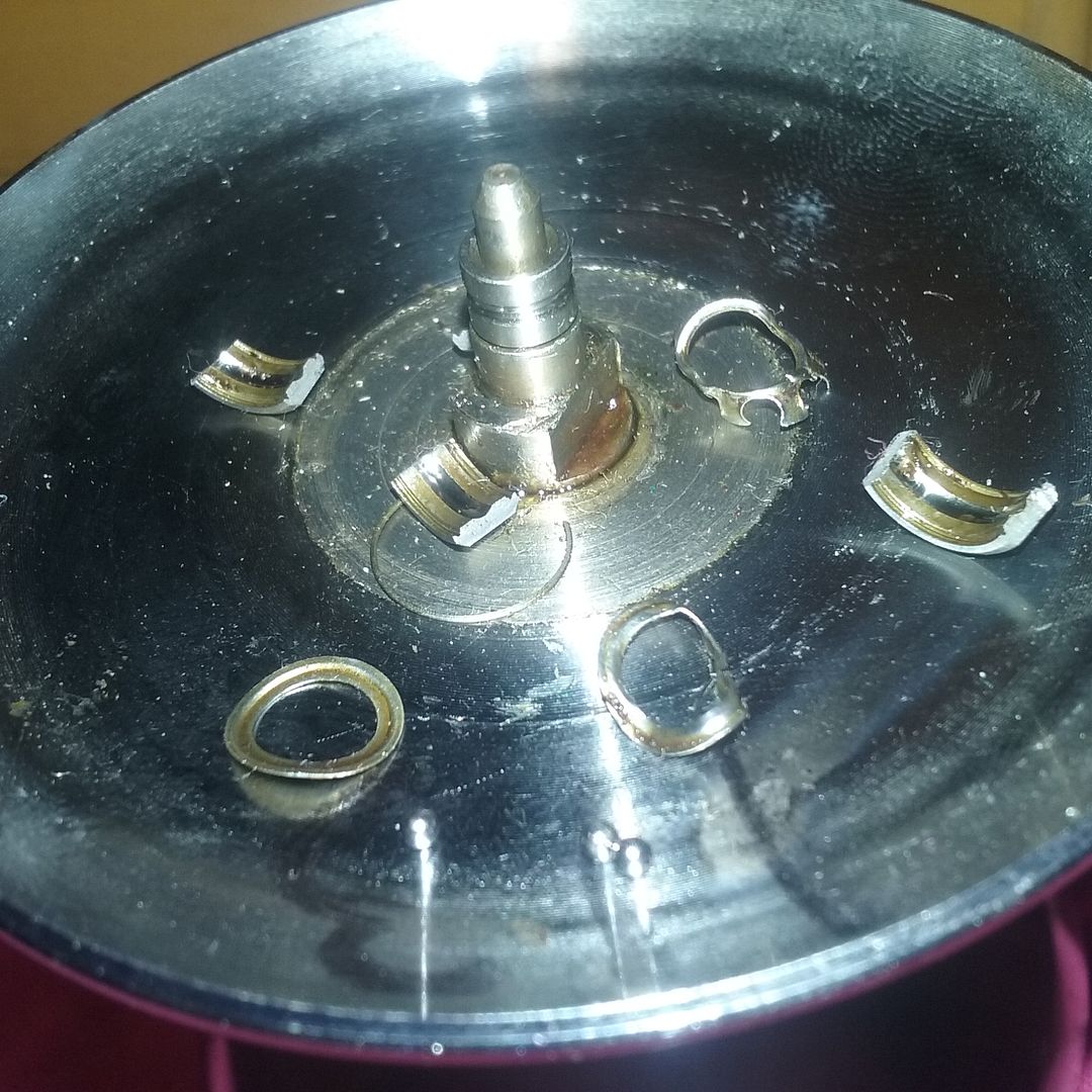

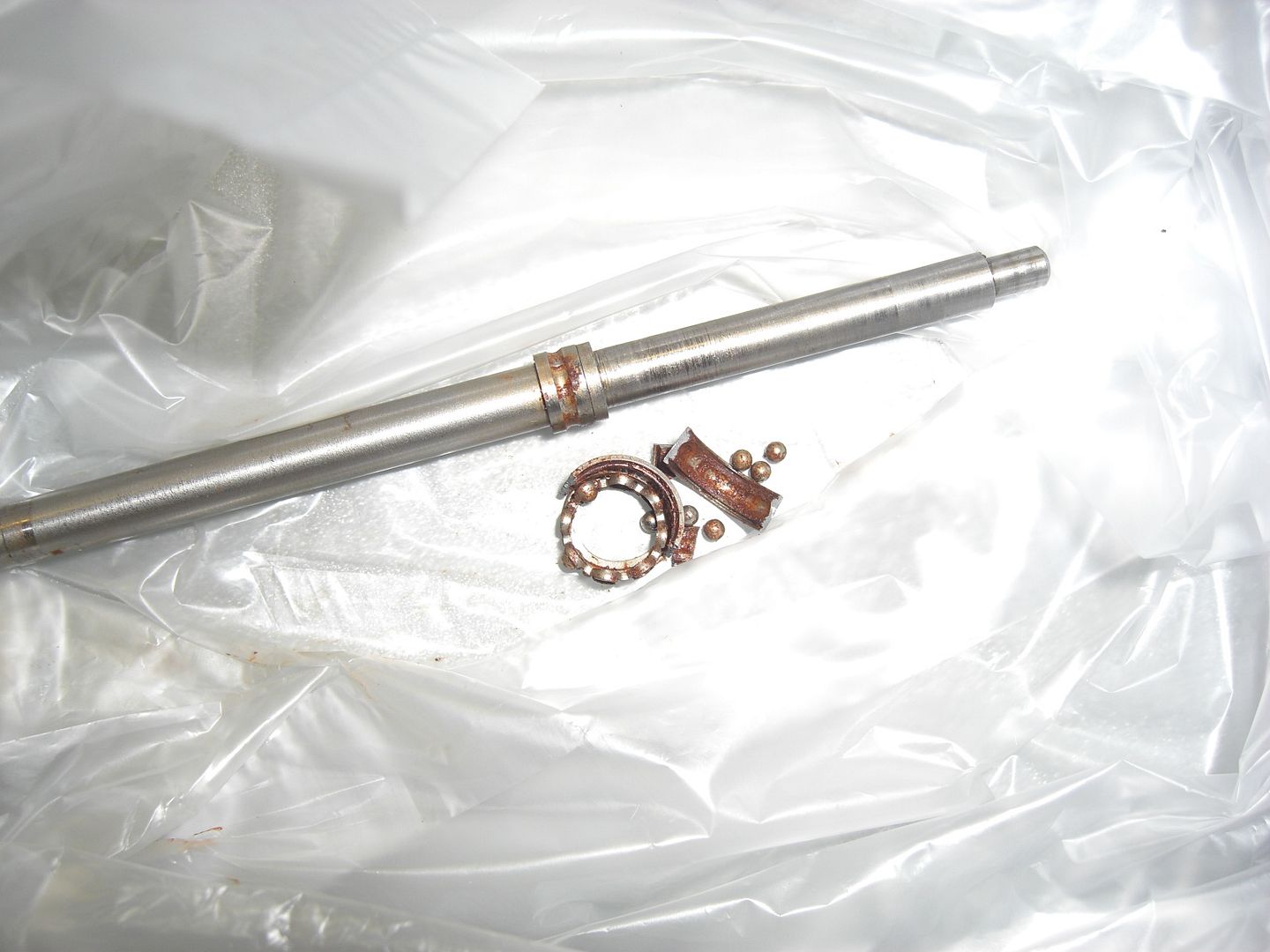

Plumbers pliers were used to crush the outer race, cage and balls - captured inside a plastic bag - leaving only the inner race behind:

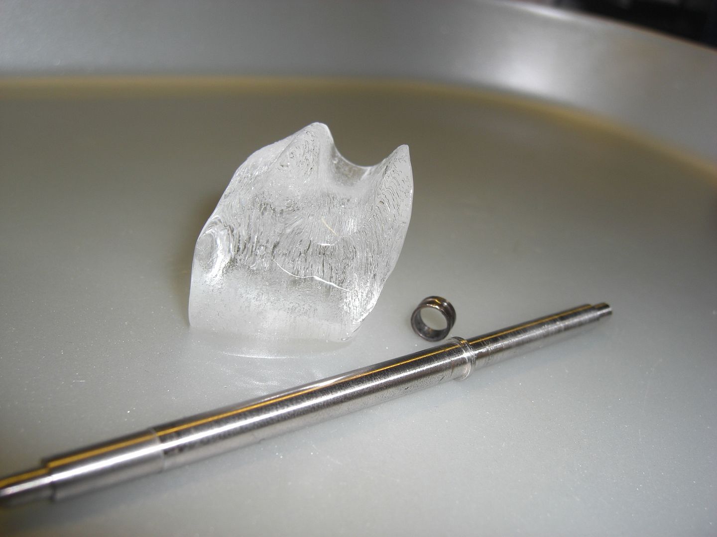

Three cycles of heat (applied by an eagle jet torch) and ice, followed by a drop or two of oil and the inner race was gripped with plumbers pliers and removed with minimal fuss:

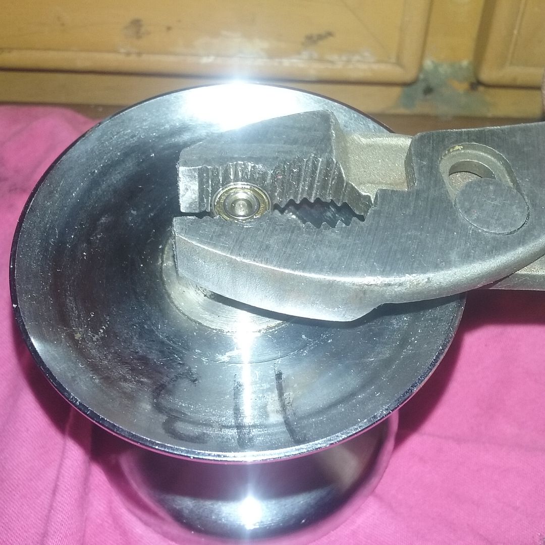

I have used a small vice grip to clamp on the race and twist after using penetration oil and let sit for a day. Then twist the spool.
