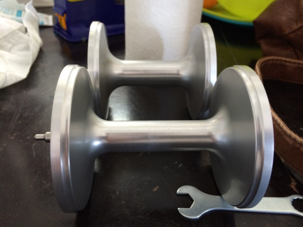

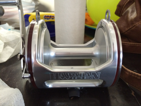

I picked up this reel last week from a Guy in Arkansas.
Said it was too much for him. New Production and looks very good.
I'm Curious to see how it looks inside, being new and all.
First thing I notice is the sleeve has way too much lateral play.
Looks greased well. Hey, there is an ss dog in there.
Somebody beat me to it, but the stack is still dry as a bone.
I have to get up at 5am. I'll finish this later. I'm out of time.
Sorry for the lack of assembly pictures, but I had to get to bed.
12 Hour days again this week. Ugh!
The dog spring seems to have vanished, Had to get a spare.
SS Sleeve and two shims tightened it right up. Stack all greased, ready to go.
