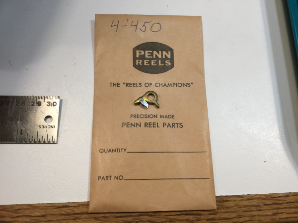

The rotor nut was loose and the dog was missing part of the metal.
I have any other dogs in stock but not this one. ::)
If it would have been any other one. I have it.
Cleaned all the bearings and removed one shield, Made a feeble attempt to make a sprung dog. It didn't work.
I'll get the proper dog to make it complete. I put it back together as is for now.

I found a 450ss this week for 40 bucks. It was in 10 condition.
It just had some bail issues. Listed as a penn ultra light.
When I got it. I took the bail and all the springs off, because there seemed to be a anti reverse issue.
The tab that keeps the dog in place has been broken off as you cans see in the pic. (it is next to the bail wire)
Never seen this before. I will buy a new housing to take care of that.
I was going to drill it and put a pin or wire in it, but $20 for a new housing will be the better option.
I'm still only $60 deep and this reel is as nice as they come.

I managed to get the parts in a few days without bothering Fred. ;)
Brand new body from Betty and Nick's tackle for $20 bucks shipped.
A bail screw and two springs for $9. I will be making her purr this weekend. ;D

Took all the parts off of the old case and onto the new.
I have did quite a few of these, but there is still an issue with this dog.
It has been beaten enough to break the tab on the old one, that it grabs intermittently.
I'll get it right, but I am happy for now. Pretty much brand new 450ss.
