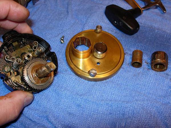

on your 12th pic  it shows jacks springs with spring arm facing up from yoke springs to hole in eccentric ...ive recently took apart a few 965 and 975 ..never been serviced...and the jack springs are installed just the opposisite of what pic shows...what is correct installation...mine have had all coils towards push button ...with arm coming down attaching to eccentric..a reply back to this would be appreciated to make sure installed correctly...where they put in wrong on your pic of reel..thanks joe
this is correct.  it would not work any other way.   :-\
joe k
two of the reels had springs put in as schematic shows...not as your pic..guess I will leave them the way I found them seem to work fine,,parts 20--965  20b-965...either way
Drisse
Hi !
Opened up thisone. When you press freespoolbutton and then crank, it wont go out of freespool. Had a look at the liftarm, and saw that the little "pin" was a bit beaten.
Or there should be spacer or something, so that the the little pin could engage the driveshaft ? I guess the pin on the liftarm is to much worn down.
I don't think this reel have been opened since it was new and noticed that the springs are installed different, than from Alans picture. Its mentioned earlier. Any idea why the springs are installed in different ways ?
If I need Penn parts, any good webshop that ships to Sweden ?
The springs are in the correct way in both pictures. Just reassemble like the picture you have. It is correct..
Drisse
Thanks handi2 !
What do you think about the liftarm ? I think the little "pin" is to worn, but I'm just guessing.
/Andreas
I too would be guessing. After a thorough cleaning and luring it may work much better. Also try the jack springs the way Alan shows them and see if that helps.
