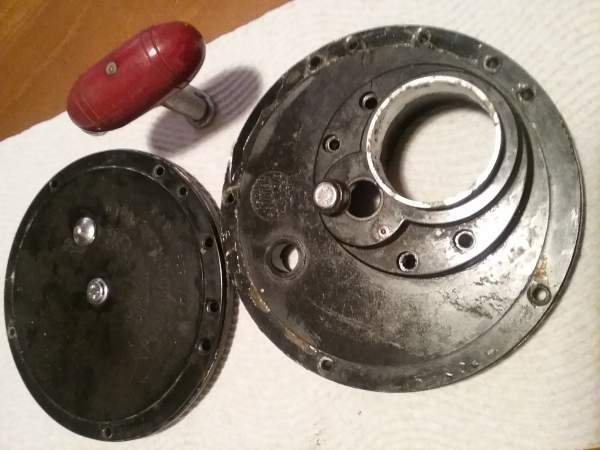

 Hi every one, hope your all keeping well, I need some help with a senator 10/0, I just received a penn senator 10/0 reel, I am a little confused with the model and a few other things, as with the picture I have included the handle, that may help to determine the model, the back face plate has a roller bearing, very small like the bearing in the front plate, the bearing in the back plate does not have a spring with it, or the extra thread to adjust the spoon tencion, like most senators I have seen, is this common with the 10/0 senators, also the chrome/ brass rings need replacing, I thought I read in the senator tutorial some where that some one make sain less steel rings, can any one tell me who this is, with there contact number, or email contact thanks, I will also need some keyed & eared drag washers if anyone sells them for 10/0 reels, I will also need metal drag washers for a 9/0, and a black 114, 6/0 reel,I don't mind cutting my own cf washer, thanks and cheers Don.

Try Mystic Reel Parts (MysticParts). They also have the shims for the spool If needed.  You have the later style 10/0 before it was discontinued. The earlier style had bushings instead of ball bearings.        Rudy
akfish
When you get the rings, I'll bet anything that you'll need to Dremel down the edges of the side plates. The rings break most often when the side plate swells -- which is likely why yours needed replacement. Shaving down the side plates isn't hard but it can be time consuming...
Taku Reel Repair
Juneau, Alaska
907.789.2448
Army_of_One
The two posters above are spot on.  mysticparts.com should have everything you need.  You can look for most of what you are requesting under the 12/0 as well.  akfish makes a good point on the side plates.  I would test them before putting grease on.  I took a file and rotated the plate on end to gradually grind down the two rounded contact points.

Donny, no one makes stainless rings for this reel. You didn't say why you had to replace the rings, was it from corrosion, or were they actually split? The answers above referring to filing the plates assume the rings had cracked from plate expansion, but you didn't say why you have to replace the rings. If they weren't cracked there's a good chance you won't have to do any filing....
okay Sid, the old rings are broken, at quite a few screw holes, what a drama I am having with my purchaces, turns out the second 10/0 I thought I brought yesterday, is actually a 14/0 not a 10/0, so now I am in the market for 4 rings for a 10/0 & 1 face plate for a 14/0 or I try to restore the front face plate on the 14/0, I will have to scratch my head for a few days ay ?, Ha Har, well I can still laugh, cheers Don
Donny, if you want help restoring the faceplate you can send it to me if you think it won't be prohibitively expensive. I've done a few, post pics if interested....
