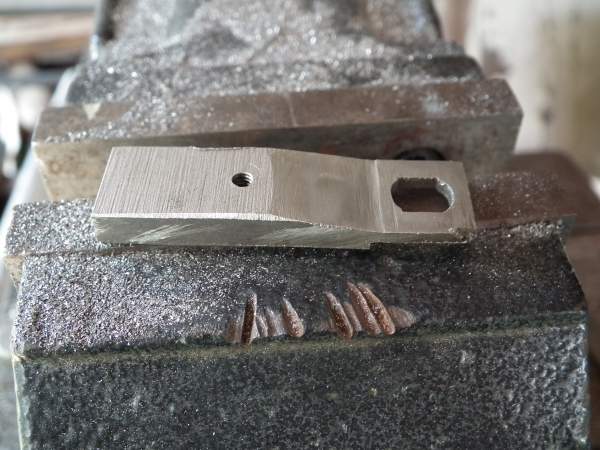

I've given the side plates another, hopefully last, application of carbon - epoxy mix today, and made an eccentric lever.
The plates were cut down where the eccentric rests so I need a slightly shorter (~ 2 mm) lever to maintain the same arc of movement.
Stock 210 levers are bent to follow the curved profile of the plate;

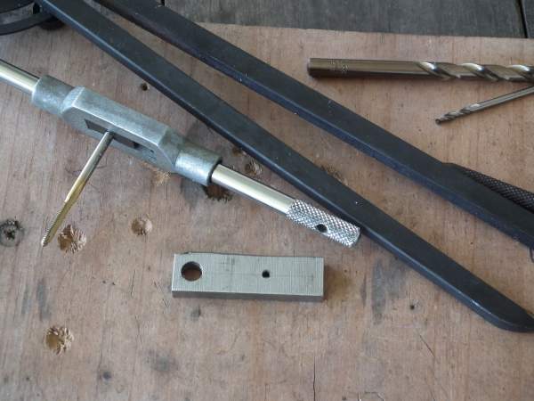

I've liked the idea of wider levers that Ted (Maxed Out) started and Chris (Rothmar2) made for his jigmaster project, so I thought I would try making a tapered lever out of 6mm 316 SS instead of a bent lever. The first step was to mark and drill the hole for the center of the eccentric hole and drill and tap the hole for the stop;
Next was to file a step to match the depth of the bend in the stock lever;
Then file a step on the opposite side of the blank to make a ~ 2 mm thick tab where the lever attaches to the eccentric;
File the taper between the tab and where the stop attaches;
and check the taper on the side plate;
A view of the taper with the stock lever;
I was thinking simple straight lines and trimmed the blank to a basic wedge shape;
No photo on the plate, but the straight wedge looked pretty bulky so I decided to drill a couple of holes and soften the edges, I didn't get many photos of the process but the file marks on the first photo give an idea of how it was done;

Thanks guys, I'm happy with how it turned out but it was a bit accidental and over the top in the end. The taper to replace the bend in the stock lever was intentional but the rest sort of happened as I went - for example the oblong hole was the result of making an off-center drill hole symmetrical with a needle file.  :-[
