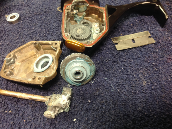

working on a "normal" reel for a change!
not that it matters, but the last guy to work on these put one of the frames on backwards.  judging by the amount of corrosion, these are going to take a while.  too bad the last guy didn't add a little more grease.  beautiful reels.  just alot of corrosion.  sad, really.   :-\

theswimmer
Errol Flynn
Some people just dont care...
Alan at least you weren't working on a bag full of Charter spinning reels that all looked like this.
