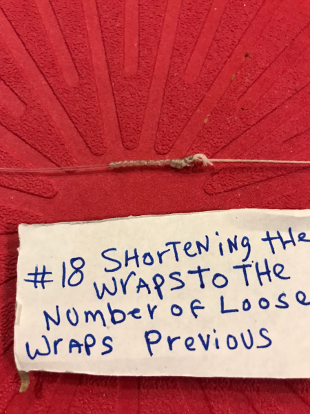

Thanks again for everyone sharing some thoughts on this knot.  Here's another picture of the newest gs version of the knot.  I've shortened the wraps some and eliminated approximately the amount of wraps that were loose on the earlier attempts.  This may have been a culprit as well as keeping the crossing wraps tight.   Butt it's looking better.
This version is done before the most recent idea of making the crossing wraps and using a single half hitch.  I may have locked the knot so it could not grip the mono?  Adding the finishing hitches did not ever help.
    When testing not all of the knots wraps were working.   I,m staying on this one ☝️ as a challenge!

Three se7ens
Quote from: gstours on February 02, 2019, 04:56:19 PM
          Thanks again and more later.
Now that looks pretty good to me for a light line FG.  Some pressure on the leader will straighten out the bit on the right side.
I have noticed they occasionally end up sideways at the tip guide when winding back in.  Flip the bail, drop a little line and try again usually works reo remedy that.  But I figure thats a small price to pay for the casting performance of a good FG.
