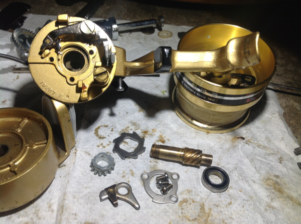

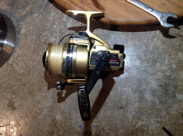

Ok, my entry to the "B" list party. A Diawa GS3. GS= Gold Series. Birthdate 1977. There are SS-Silver Series, a slight downgrade from the GS and then ~'79 or '80 or so confusedly, the SS= Super Sport. The Super Sport's had the fancy wood handle knobs and some fancy spool engraving. Better internally-I don't know? The next versions were the very popular BG's(1980- present)
This is a B reel to me cause they are very heavy/size, probably have some kinda alloy main gear and I'm prejudiced against 1970's metal and other materials used on Japanese products. I tell you what though, the design engineering is excellent, IMO. Accorrding to a thread from Stripersonline,  Diawa spinners from this era are sturdy, longlasting workhorses.
Great features: spring-button fold down handle; silent dog-ear style anti-reverse located on top of the gear box and underneath the rotor. It engages a seperate ratchet on top of the pinion gear; metal covers over both the bottoms of the bail arms; a heavy-duty click spring system oppsite the anti-reverse(engages only in anti-reverse mode); a 4.8:1 gear ratio; and besides the pinion ball bearing, only 1-b.bearing for the main gear shaft. Switching it to right side cranking will put mosta the load on a brass bushing for that side, which is fine with me---one less b.bearing to service.
"How come?" Why not engineer it with a spring loaded AR pawl to get the anti-reverse "clicking" sound? Why have a whole other system to produce the AR click? The reel's heavy enough, why add more parts($) and weight?

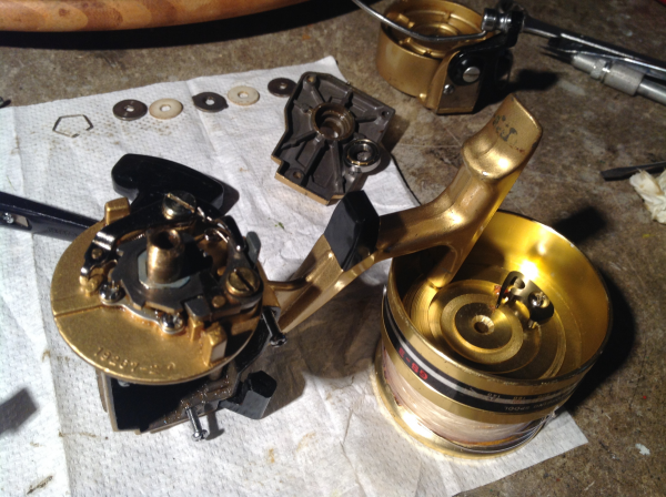

A few more pictures. Also note the tiny diameter of the drag system. Looks like teflon and an unknowen bottom washer for the friction discs---another B reel aspect for me. Ok, one more B reel part: a plastic drag click pawl.

   Thanks for the look inside that Daiwa G, I've been curious about those. I see it has a bearing on the main, and a bushing on the side that sometimes gets no love. That main looks machined rather than cast...that would be a plus too. Bonus points for that AR system also. The drag system may fool you. I've learned there are no rules when it comes to drag systems. On paper, large surface area and multiple discs is the ticket, but I've sure seen real world results prove otherwise. All in all...that's a high scoring B-grade! 8)

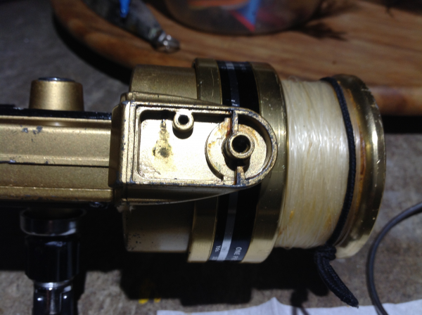

Alright, then, sorry for messing up the post sequence, but I couldn't get to the bail on the GS-3 till now.
I can see a weight issue if holding the reel/rod for several hours while standing in the surf. I'd say it's a medium-large freshwater or light saltwater reel.
The bail system is not as heavy duty as the rest of the reel. Note the rather flimsy single spring. It would be pretty easy to work on, however. There's good and bad with most things in this world. The bail arm bangs against that projection on the stem to close(bad) when cranking, but it also can be flipped back over by hand(good). The deal would be to get used to hand action, except for those rare times when you gotta stop the line quickly.
