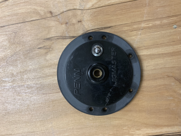

So I finally sat down and disassembled my Jigmaster 505hs.
[/URL][/img]
I now know that I need a new sleeve and drag washers at the very least. My current questions are should I go ahead and put in the stainless yoke and eccentric jack and I think I read on the site that the stainless gears for a Newell 200, 300, or 400 will fit the 505 Jigmaster like factory but with a gear ratio of 3.6:1 if this is true would those be a better choice than 500 Jigmaster gears.
A little fishing intent for the reel to provide context: the reel will be used primarily for freshwater Striper, and large Flathead and Blue catfish. The reel will also see use at most once a year in surf fishing an/or pier fishing anywhere from North Carolina through both coasts of Florida.
