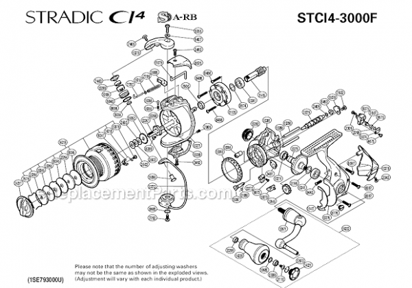

So I made the amateur mistake of setting down my $500 rod/reel while fishing today instead of putting it in a rod holder.  My circle hook performed flawlessly, and a 23" trout ripped my rod from the boat.  I put a treble hook and lead on another rod and caught my rod in 18ft of water thankfully.
So here is my question.  To what extent do I need to service the submerged reel?  Do drag washers need to be replaced?  I tried to find a stradic tutorial but had no luck.  Any help will be appreciated!!

I started working on this a couple of hours ago using the thread linked below.  I am INCREDIBLY surprised to find that no water made it into the reel or drag stack.  I guess the seals do work.  There is quite a bit of fine dirt in all of the nooks and crannies, but easy to fix.  I'm dreading reassembly!

The spool will need a complete disassembly and there are some tiny parts on the bail arm side.

Yeah I noticed those tiny parts!  I could tell the tiny white plastic thing gose in the little spring, but I have no idea where the tiny copper washer goes.
