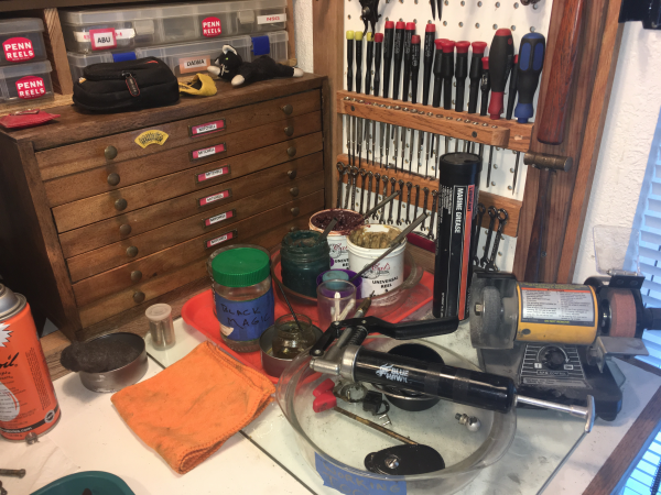

I still use cal's grease just for drag washers and yamaha marine grease for everything else.
#13
Same as Alan — I just use Yamalube Marine & Cal's.
For me, on repeat jobs after a couple of years — I appreciate the way Yamaha Marine and Cal's stay in place doing their job — then wash out clean and easy with solvents.
Go through maybe 4 or 5 pounds of Cal's in a year, and about 8 or 9 (14 oz.) tubes of Yamaha Marine that I apply with a grease gun — or a flux brush with the bristles cut short.
Any grease used is likely going to be finer than nothing — the exceptions being greases that sets up hard, or greases that stick to everything — and will not wash out except with an hour of scrubbing and $5 worth of chemicals.
Just keeping it simple, effective, and with good protective performance...

#14
How have yall found that Penn grease cleans out? Pretty hard? Or do solvents work pretty good on it? And just curious Fred, what is black magic?
