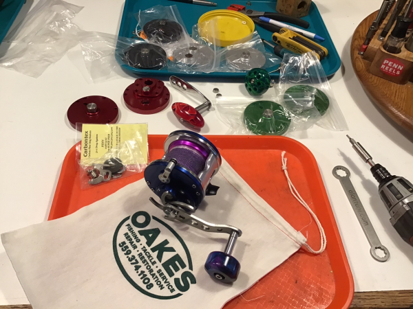

Finished up PJ's little 501 this morning.
He has used it fairly extensively over the last 3 years.
These custom builds sometimes take a little finesse to get them dialed in.  Tolerances are tight.
Installed one of Bryan's drag stacks, a new jack & eccentric, and a tension spring.

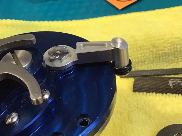

Also did a beveled modification on one of Ted's fantastic shift levers in order for the center-line crank blade to clear -- then replaced the old factory shift lever.
Free spool is long -- and the drag is very strong.
When I built this for PJ a few years ago -- it was also magged at that time.
Will send it out tomorrow, PJ.
Nice work Fred. Mini tank
Tom makes a lower profile lever that gives better clearance for offset blades. I doubt anyone will notice the shaved lever
