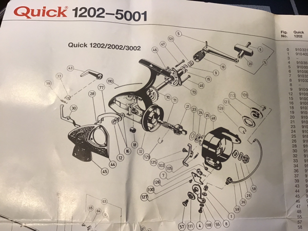

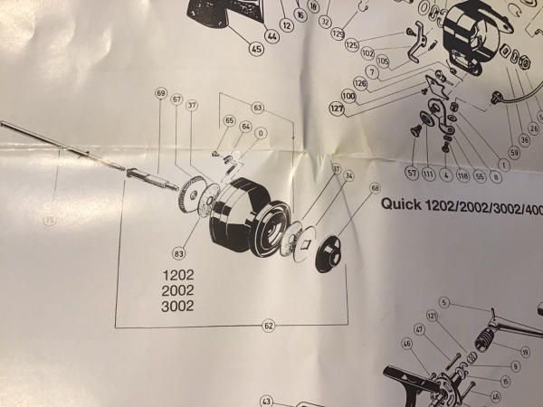

Is it just me or is a schematic for a 1202 not available? I've been looking for a while and I see there is one for the 1001-5001 series but there is not a column for the 1202 in the parts list. Am I looking at the wrong series?
I'm trying to figure out if the 1202 has a second drag under the petticoat spool.
-Mike
Yes, it has a very stiff and non-flexible underspool drag washer, Mike —
Here are some basic schematics and a parts list —
Also, have your Daiwa 750 spool — posted a response under the Daiwa Spinning section.

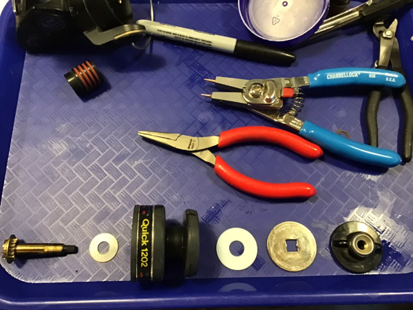

I think I'm missing the underspool drag washer. So that washer just sits on top of the clicker gear? I could tell the bottom of my spool was slightly textured and it seems inset just a little. I was assuming that there was a metal washer between the clicker gear and the drag washer, but it's just one hard drag washer? Do you have one of these?
Thanks
-Mike

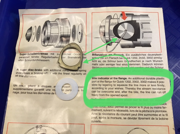

Here it is, Mike —
And I'll also send you a new bite indicator flange — save your old one.  These are a really neat feature on the 1202, 2002, and 3002.
N/C.
I never make the same mistake twice.
I make it 5 or 6 times, you know, just to be sure.
PacRat
Thank you so much Fred! I just figured out how the Bite Indicator works. I was going to ask you if this is something I should keep a spare on hand.
