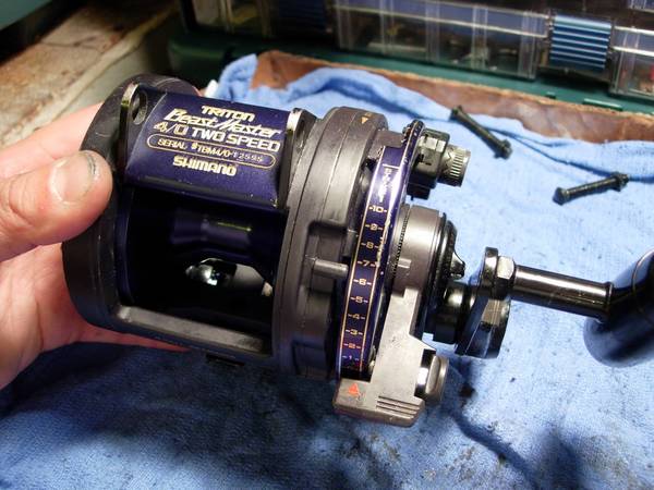

on many boards, you will see discussion about the value of a two speeded 3/0 or 4/0-sized reels.  load these reels with spectra and a topshot, and it makes perfect sense.  but what if spectra was not available?  how much sense would a 4/0 sized two speed reel make?  probably none.  so in the mid 70's, when shimano introduced the triton beastmaster 4/0 two speed, a tackle shop in san francisco ordered up two of them.  and they sat.  and they sat. and they sat some more.  then finally an employee bought one.  who knows where the other is.  no one was interested in a small two speed reel.  back then, it made no sense.
with the introduction of spectra, this reel makes perfect sense!  behold, a 30 year old shimano triton beastmaster 4/0 two speed, introduced 30 years ahead of it's time!

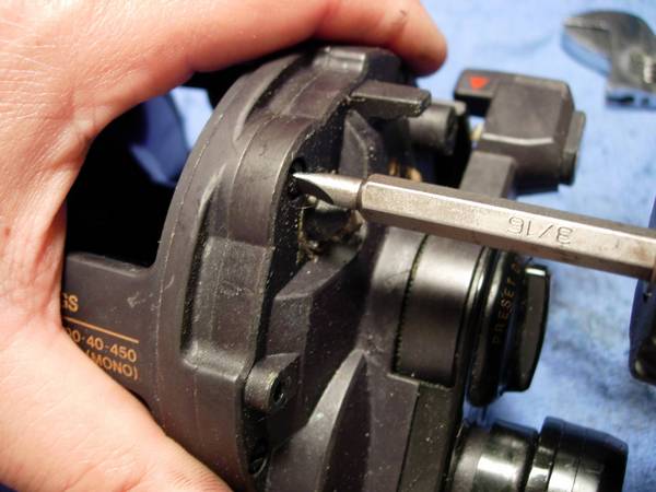

there are  two small screws holding the lug on the left side plate.  let's back them out, shoot in a small bead of grease and torque them back down again.
remove the lever quadrant.  there are only three screws.  set everything aside.

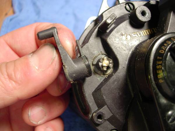

pull the clicker lever and set it aside.

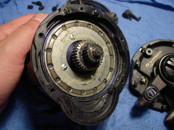

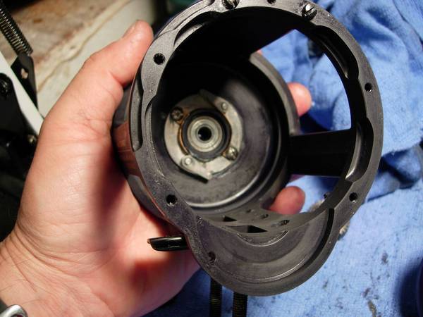

back out all of the right side plate screws.
remove the right side plate assembly and set it aside.  note that it is similar in design to to the penn internationals.
pull the spool assembly and set it aside.
the left side plate and frame are a single piece of precision cast aluminum.  again, note the similarities to the penn international.

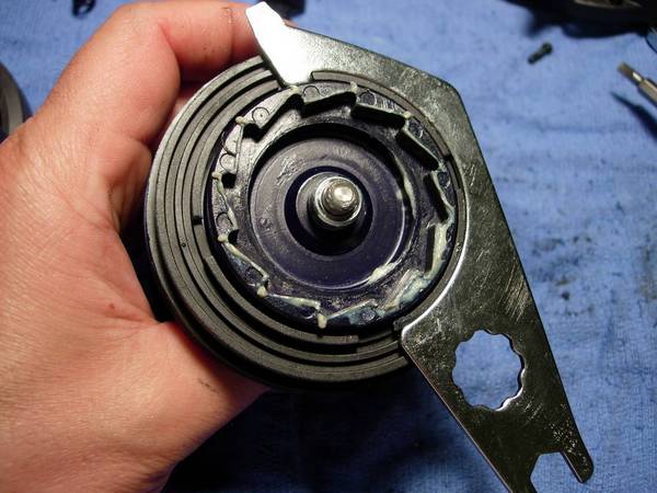

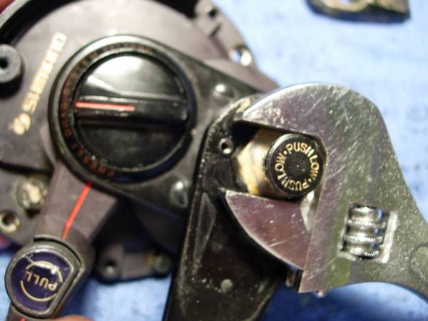

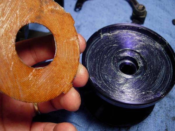

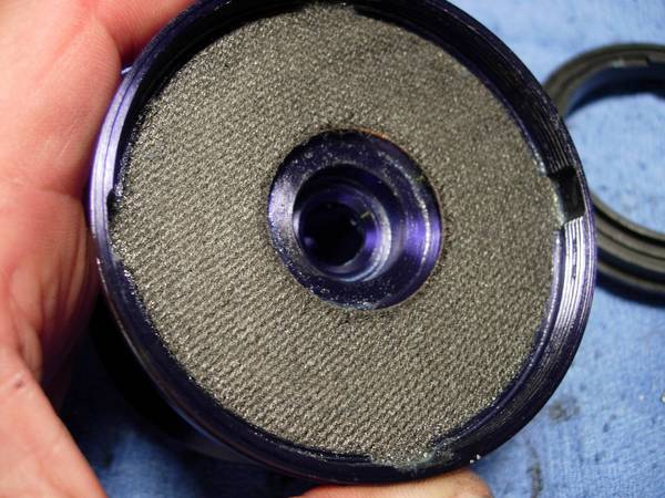

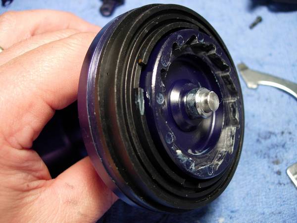

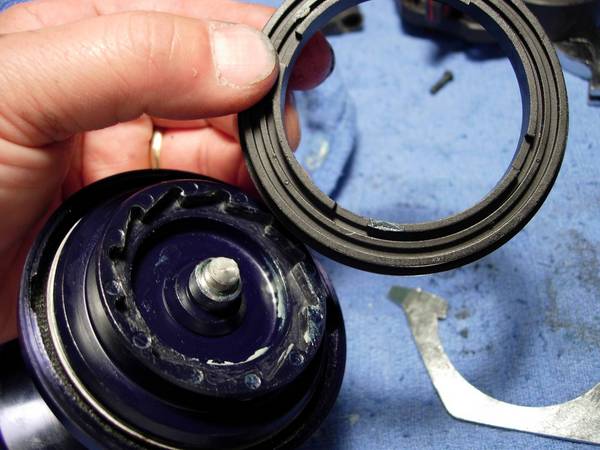

here is a view of the left side of the spool assembly.  note that the spool cap that holds the drag plate has left hand threads.  the wrench for the shimano tld 20/30 two speed reels actually works for this reel.

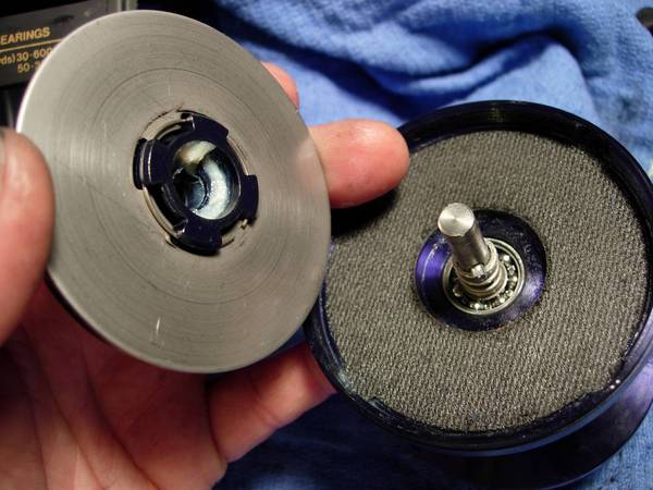

off comes the spool cap and drag plate, and look at what we find.  it's a 30 year old greased carbon fiber drag washer!

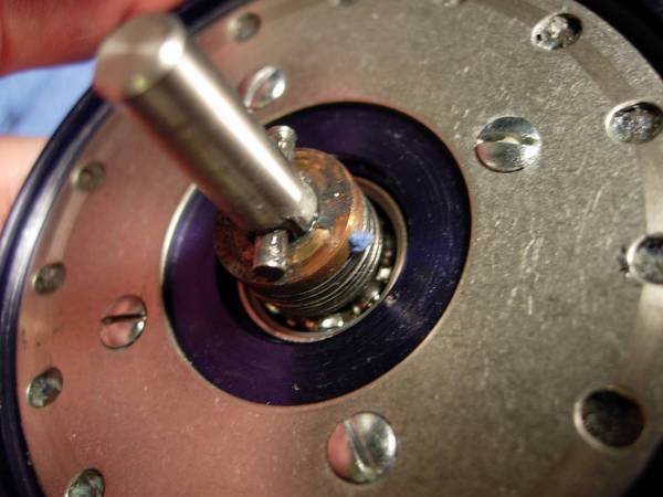

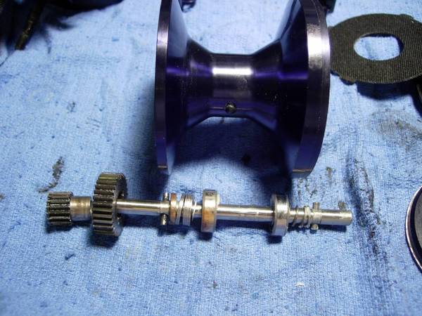

here's the spool shaft assembly, removed from the spool and reassembled so that you can see how things are arranged.

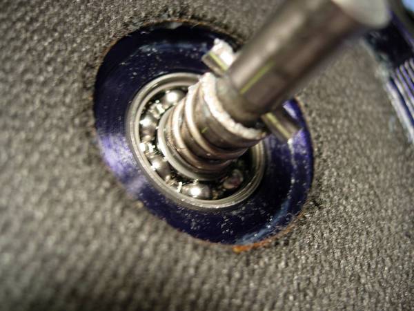

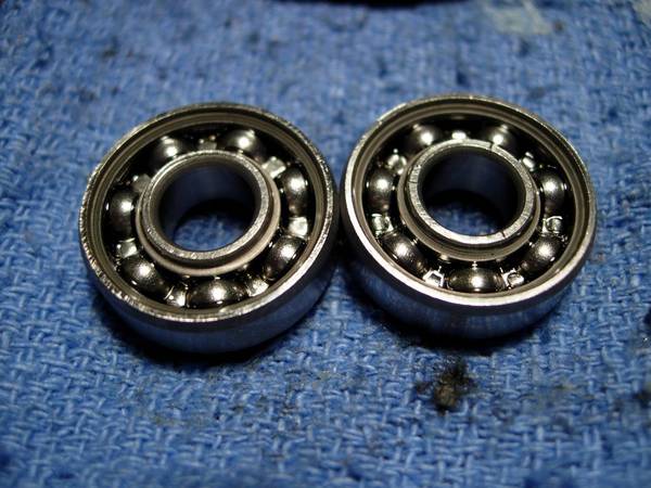

the bearings were gummed up with old grease and had surface rust only.
i pried out the shields, cleaned the bearings with carb cleaner and compressed air, and lubed them with corrosion x.

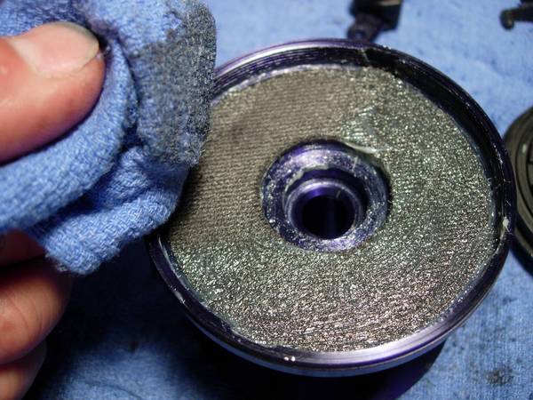

i pulled out the drag washer, cleaned off the old grease and slapped on a coat of new grease.
i cleaned off all the excess grease....
... and it's ready to go!

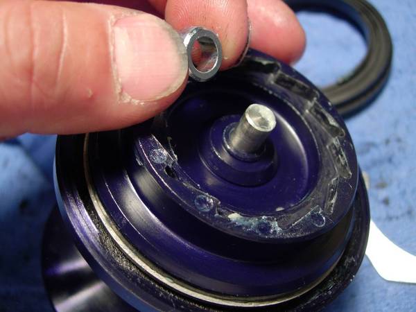

back goes the drag pressure plate.
install the thrust washer.
install the spool cap and torque it down good and tight with a tld 20/30 wrench.

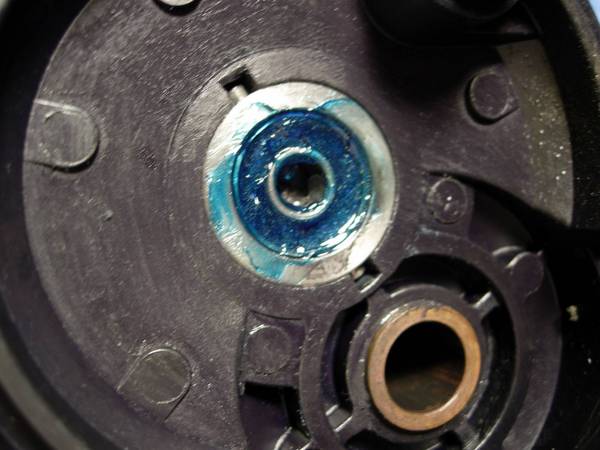

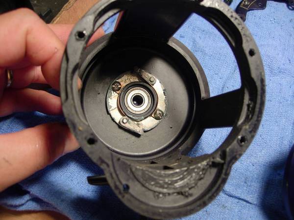

now for the frame.  pull the bearing and pack it with grease.

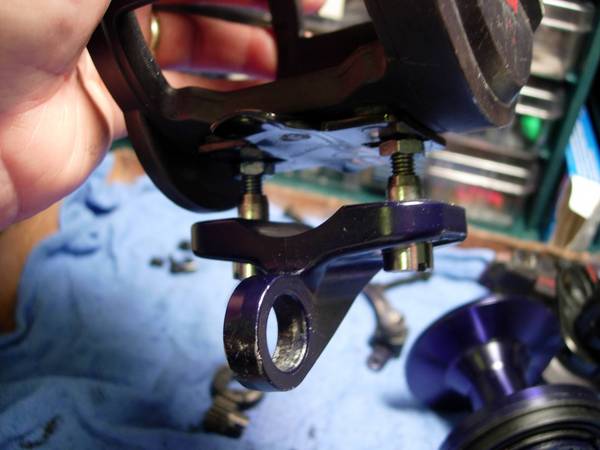

i had an old clamp from a tld 50 LRS two speed and decided to clamp it on.

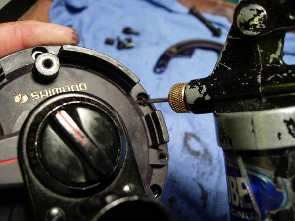

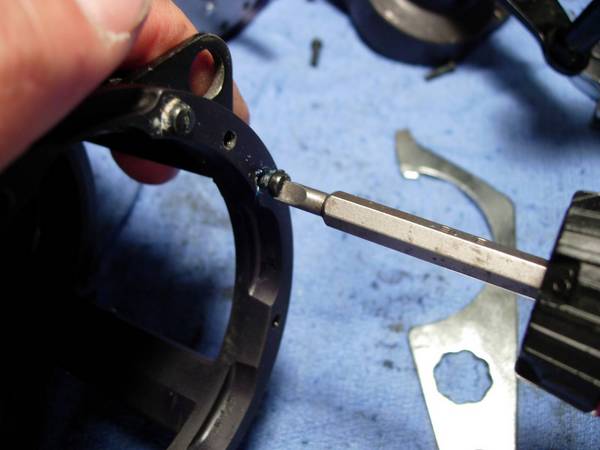

back out the two screws holding the lug on the right side, add a bead of grease and torque down the screws.

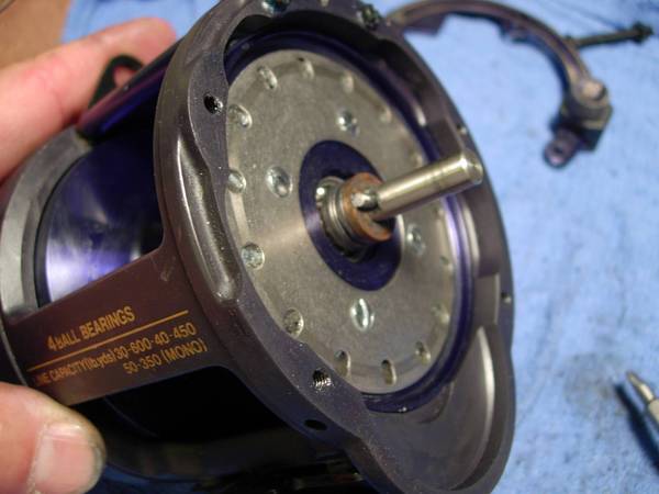

install the spool assembly into the frame.

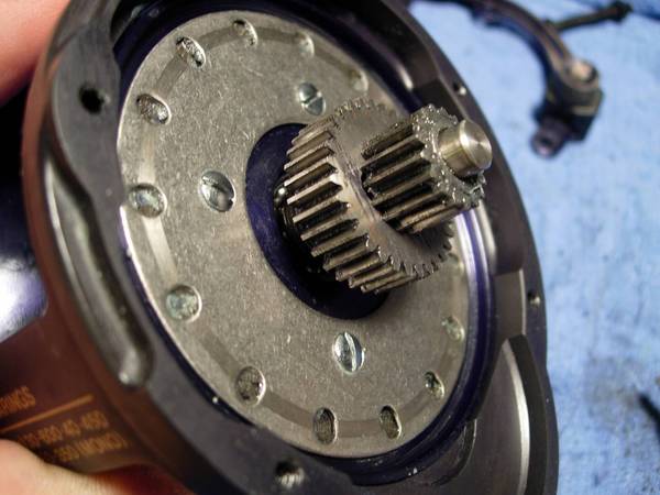

install the pinion gears.

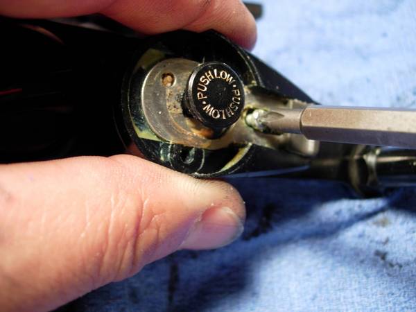

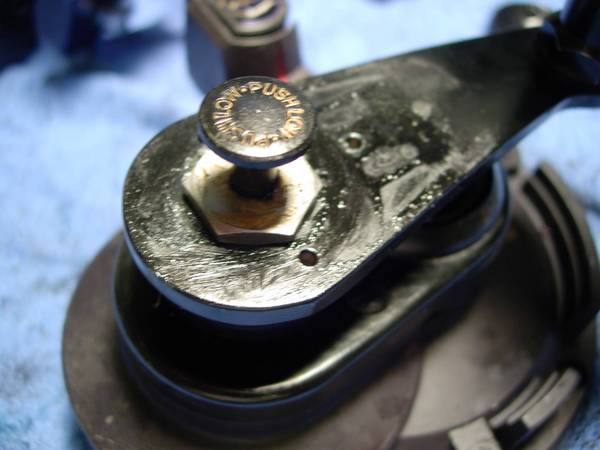

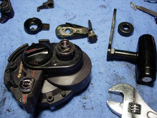

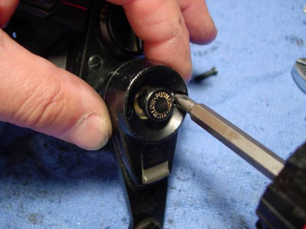

we need to remove the handle and main gear assembly to get to the right side plate bearing.  first, remove the push button shield.

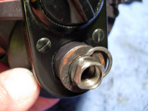

remove the handle bolt plate.
remove the handle bolt.
remove the handle.

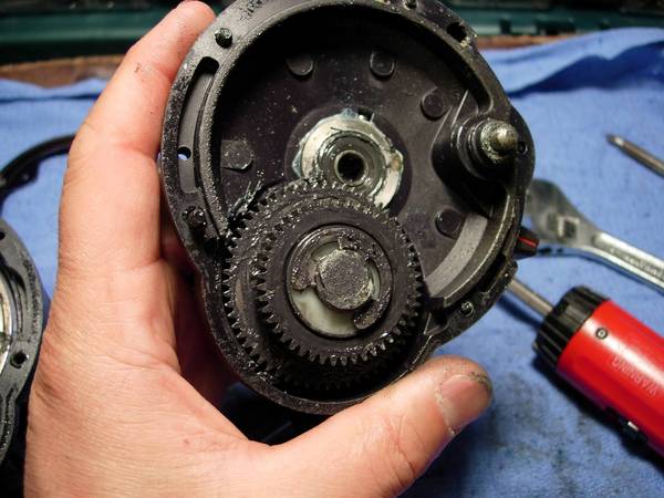

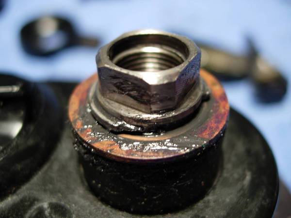

hmmmm.....  normally the main gear assembly drops right out.  it won't budge.

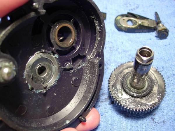

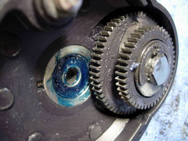

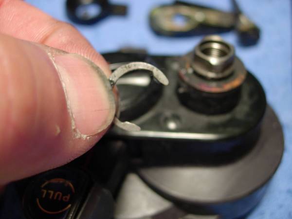

well, here's the reason.  remove the c-clip and carefully drop the main gear assembly out as a unit.

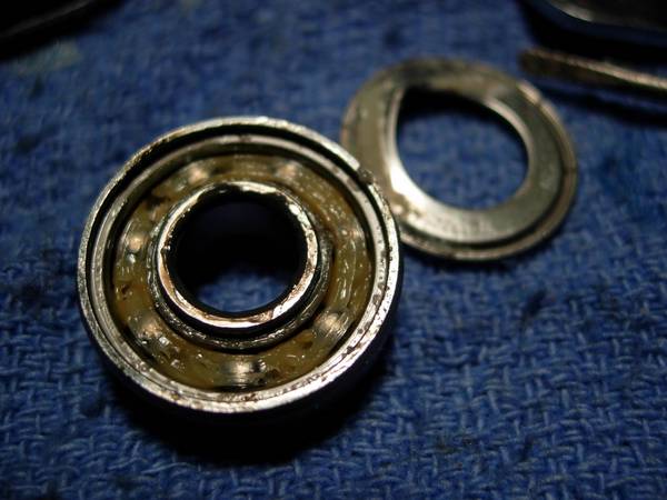

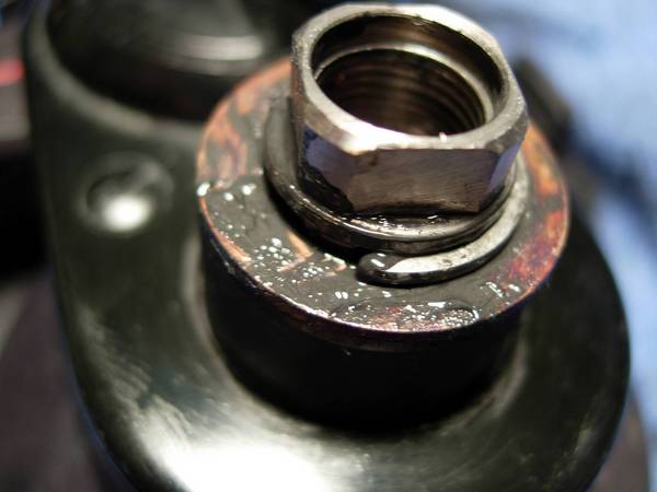

install the main gear assembly as a unit.  don't let it fall apart.
install the c-clip.
install the handle and handle nut, then the handle nut plate and cover.

install the clicker lever and lever quadrant.
