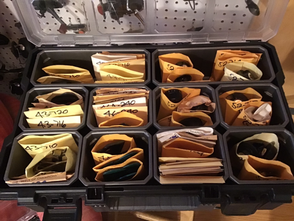

I do have those knobs — however, think he already has what it takes?
