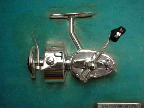

I was hoping it would be look like real gold but the powdercoater said it was a prismatic 2 part color that he had to do chrome then overlay the gold.I think maybe it is the darker aluminum may have caused the look, a more polished aluminum may have turned out brighter? Mitchell did make a silver and gold plated 300 in 71' not available to the public.
https://mitchell-collectors-international.org/articles_mitchellgold.html

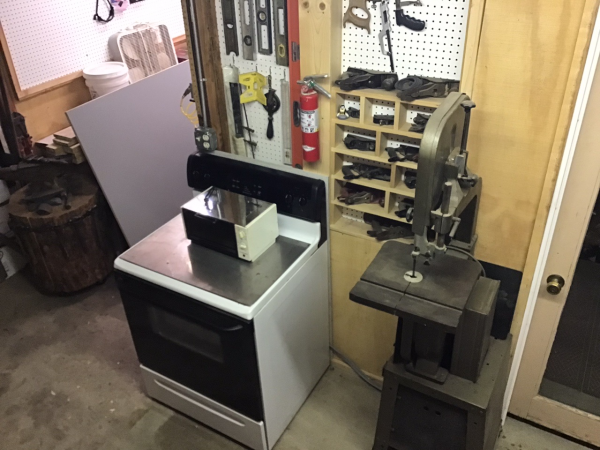

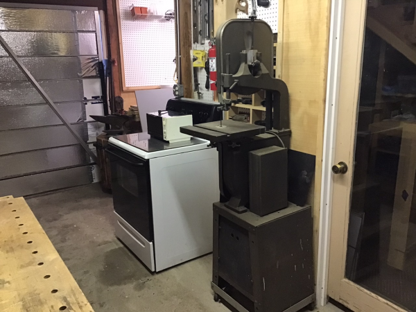

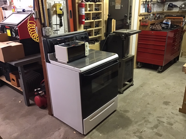

For just 2 or 3 reels at a time — I use a little, old toaster oven that we used for years when at the cabin.
Earlier this year, I decided to set up a powder-coating room and metal prep station.
Metal tables, cabinets, pegboard, air lines to the big compressor, ventilation, filters, fans, respirator, lighting, grinders, hydraulic press, drill press, etc..
Only thing I bought new was the 2 stage PC system, the cabinet blaster, a cartridge tumbler for small parts, and the accessories & powder.
Picked up a nearly new electric oven for $125 on CL — young couple was getting rid of it since remodeling their kitchen and installing gas.  Pulled off the top burners and tossed them away. Installed a piece of 3/4" plywood on top with an old scrap of SS.
I like the ability to set the oven temperature I want — and the automatic shut-off timers.  Both ovens work very well.
And we will do the Thanksgiving Turkey with the gas oven in the house.
