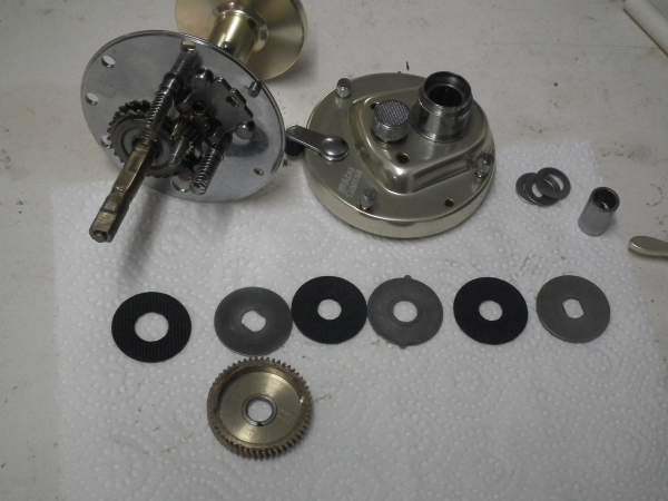

Nice reel Mo - and well photographed as usual. As luck would have it I have a 10000i that has 'Big Game' on the tail plate but it looks a little different to your 9000.
This could be one of the models that gave the 'Big Game' ABUs a bad name - it has a brass gear, IAR + one dog and three drag system. Your reel looks a lot sturdier with the double dogs, SS gears, five stack...... clearly a different 'Big Game' series.

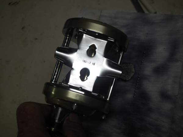

and the foot stamp for Doc (160117 15)
Quote from: Robert Janssen on January 02, 2021, 02:18:16 PM
What does the foot stamp on your reel say?
   Thanks again for the help Doc...foot stamp is 130014-01.

MHC's reel is, according to the foot stamp number if i have deciphered that correctly, designed in 2006, and manufactured after one revision in april of 2007. As noted, a later "i" version 10000i.
Mo's reel seems to be designed in 2003 and made in january of 2004 without revisions, which would suggest that it is one of the first year, first model original Big Game series.

I have confirmed from schematics and photos of the actual gear that the 10000i (16 01)  used a brass main gear.
I have confirmed from schematics and photos of the actual gear that the BG 10000 (13 02) used a steel main gear (#1092375), as well as a steel pinion (#1092379, currently available on ebay ).  The BG 10000 CT (14 01) used the same gears, as did the BG 9000 (13 02) and BG 9000 CT (14 01) models.
The prior modal 10000 CL (94 03) used a brass main gear.
So from 2003 to 2006, the "Big Game" model came with steel gears.  The prior and later 10000 models (no "BG" designation) had brass gears.  Incidentally, only the "BG" models seem to have the plus sized drag stack.
It should be noted that the available schematics indicate revision from the initial production (could not find those schematics).  So I  can't say for certain that the original production of these models had steel gears not brass.
Anyone wanting a steel main gear for the BG 10000 (13 02) or  BG 9000 (13 02), they have one left for $5.29 on closeout here
