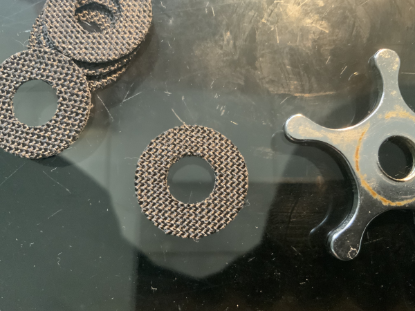

Here ar some pix he sent .
First LOOKS like there are washers on both sides of his Star so prob can leave out the inner one.
Next the ol drags are shot for sure as well as the metals  AND looks like there is still a Disk stuck in the Gear .
When changing to CF drags either the 3 stack or 5 stack set up I have found that you have to shorten the spacer sleeve about .035-.045".         Rudy
Thanks for posting these pics. I appreciate it. I broke it down last week, and it looks like it, but there are no washers by the wheel. I put the wheel on and then right after that the handle. And on the inside that's the spacing sleeve protruding out a bit. I do have two shorter options of that part (key 9) on the way. The drag washer in the gear came out fairly freely, and I had put it back in to start stacking as one of them goes first, and then took the pic. Also have new HT-100 full set coming as well.
Wompus Cat
Sounds like you have it under control and with the extra Spacers or grind one down like Jo said you should be able to get what you want.

Here's some pictures I had. 1)HT-100(part# 6-309) from Penn.

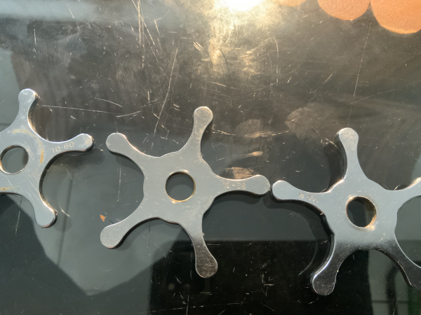

2) cheap upgrade would be a #10-66 drag star, which is larger—but also thicker! I think it's worth it to use this one, but you might haveta shave the drag spacer a bit more. It fits on the 98-60 gear sleeve you have.
Just to think about, the 10-505 drag star is a fine thread unit that fits on a better/stronger stainless steel gear sleeve—the 98-505. This set-up would give you more star adjustability.
#28
#2)
Tap on pic. to enlarge

Nice, thanks for the pics and input. My washers are definitely worn. HT-100 kit on the way. I'm sure I'll catch a little bug like everyone else seems to have on these.
