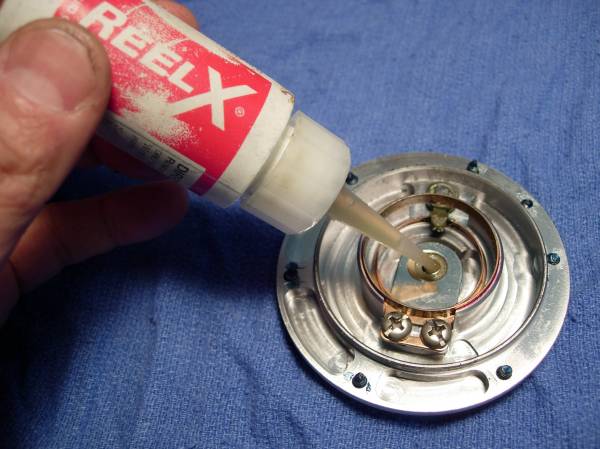

I have a question regarding the clicker.
I have a few of the 30T's and i'm having an issue with the clicker slipping.
If i put it into the "non-clicker" mode, it will slip down into the "clicker" mode.
Is there an easy fix for this?
Irish Jigger
Quote from: Irish Jigger on July 11, 2012, 10:48:08 PM
Super glue.
thanks for my chuckle for the day!
the spring is probably loose.  you will have to pull it out, squeeze it together, then put it back it and see how well it holds.  they are finnicky to say the least.
