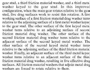

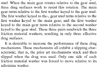

Regarding which washer slides on a floating washer, trust me. It is as said- the rule is that only one surface may be counted.
These arrangements are not unknown to science, and methods with which to calculate them can be found described in engineering literature, not leastly in automotive context.
But here, have a look at it in Penn's own words:
...and that's how it works.
Regardless of how many discs there are and how much drag is needed, it is still just nice to know that this arrangement does what it does in a more efficient, space-saving manner.
And that so much drag might not be needed doesn't really matter. That just goes to say that one needn't tighten the drag star as hard. (Maybe my car has a gazillion horsepower. So what; it doesn't mean that i need to use them all, or even some of them)
Doc.
