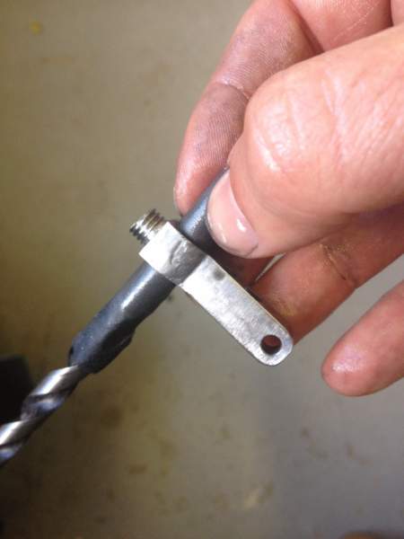

To follow up as promised. But this one has ended in frustration.
The reel I had on my bench had a faulty levelwind. Two things wrong, the shaft is damaged
And the guide was cracked, it actually snapped the pawl cover sleeve clean off when trying to access the pawl
Here is another cracked guide from a previous reel that also had a faulty levelwind, and the entire worm/guide/pawl assembly was replaced.
It's these guide failures that prompted me to attempt to make a stainless one.
I had roughed down the part from an M16 SS bolt on a 4-jaw chuck at work, and drilled the holes while at work. The rest of the guide was shaped by hand filing. The pawl cover was  machined from some 10mm SS Rod, and threaded M8.
All holes were honed with wet/dry of several grits, 220-800.
And also polished with  Autosol by spinning it in on a drill bit.
The SS guide support rods were also given a polish with Autosol. While everything seemed to slide OK off the reel
There was binding at the end of travel at both ends, which even after carefully honing the bores several times, I couldn't improve. It seems as though the stainless would gall onto the guiding rods. I thinned down some grease with Corrosion X, and coated all parts, but no improvement could be achieved.
In hindsight, I probably needed to make some delrin sleeves to slide over the guiding rods, but that would require re-designing the guide to accommodate them. There is not much room to play with under all the cover shrouds. Alternatively, the guiding rods could have been skimmed down on a lathe.
For now, the reel's owner has decided to cut his losses and look into the purchase of another reel, type/brand undetermined at this stage.
So there you have it, I don't always succeed with my projects.
Now I have a bunch of Tiagras to service......
Robert Janssen
Cool. A for effort.
QuoteThere was binding at the end of travel at both ends, which even after carefully honing the bores several times, I couldn't improve. It seems as though the stainless would gall onto the guiding rods.
Actually, I would venture to guess that the holes themselves and rods are fine, but the holes c/c distance is ever so slightly off. Which is understandable because, to be honest, drilling perfect holes on a perfect c/c is in fact more difficult than it may seem.
Maybe you could figure out which one (sharpie + rub mark test?) and enlarge it a bit; make it work, so you win the game.
