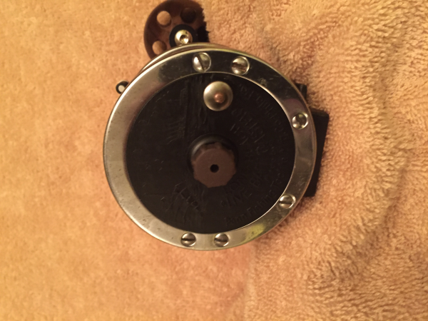

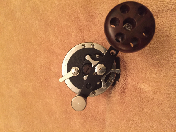

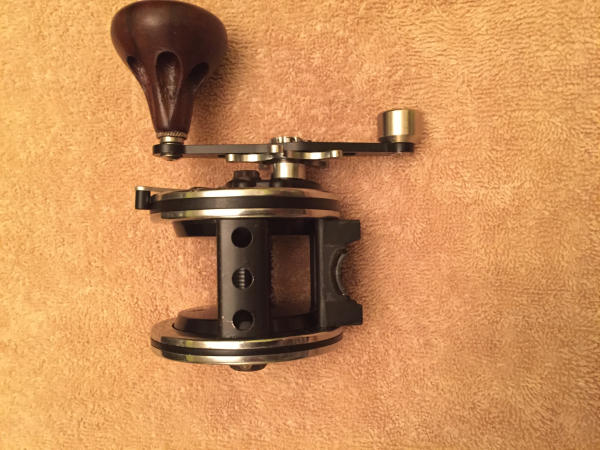

Had some free time so I pulled out the 259 to see what I could do. It's an older one with no part numbers but some had put a Newell spool in it and was no beauty queen so I figured it won't be on the shelf. Checked the bone yard for parts and found a Newell base and bars and some "Teflon " bushings  also had a progear handle arm and a pro challenger 501 spool looking for a home. Had a few Cortez Conversions levers so I used one on this.
I opened the reel up and a nice steel main gear with smoothie drag washers which I replaced with CF. Nice clean and greased inside, the only thing wrong was the gear sleeve was rounded off. Found a nice one to replace it with and the insides are ready to go!
Got it all back together and it should be a nice reel for fishing 20-25lb.
BIG thanks to Sal for the nob he made for me. This ones walnut,it's very light and a perfect fit in the hand.
xjchad
Looks great Sheridan!  I love how you made all the parts work together!
The knob is a beauty too!
Husband, Father, Fisherman
the 259900 LongJohnSilverBeachLiveBaitmasterJigCaster....went together no issues with 259 tail plate, 99 spool, 24-66 stand, 500 jigmaster headplate, and some stuff from Maxed Out: customized 99 width solid bars. I later replaced handle with progear blade (from Ted also) and custom knob.
You should have little to no issues if all parts are factory-true.
