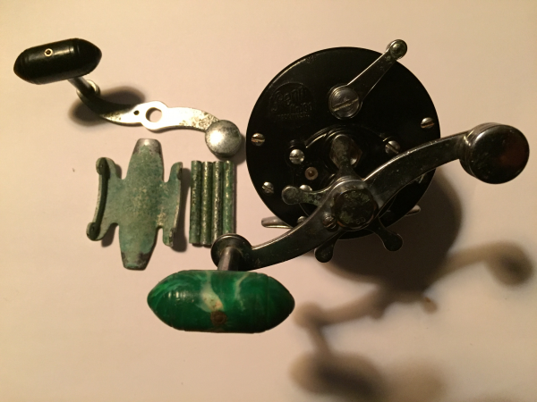

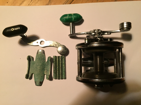

I've owned both the GTi and the GT2. The GTi I had came with a black handle arm. The GT2 came with a silver handle arm with a flat rubberized knob. The later Chinese version of the GT2 came with a silver handle arm and an oval knob.
