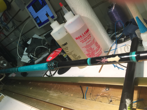

Yes it can be done most of my party boat rods are cord with Turks heads
45+ Years of fishing and rod building its been an adventure!
DBCFR
Pardon my messy wrapping bench but here is another one on a
Phenix 909H in Calstar colors with cord handles
Also here is a set of cord handle trigger seat cousins BT8050,BT8025,BT8020
all set up for Lexa HD 300 & 400 reels
