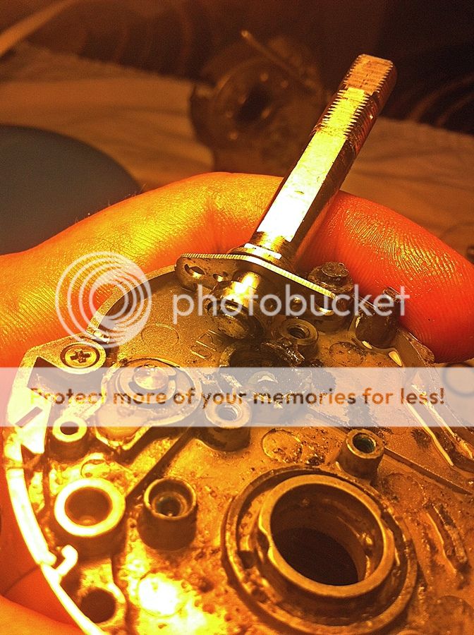

A lovely mix in the end - various spraycan lubes, protective oil spray, anti-corrosion spray, freezer + hot water, and repeat..
But I believe that the most important component was the one I thought of using after seeing that I could not "attack" the bearing from any side, due to that it is sitting fairly deep in its place, plus that bracket really made it annoying not being able to really get to it.
So after looking at various tools etc, I decided to go for a tool that has helped me a lot - a scalpel. Not one of those crazy sharp ones, this one has seen it's fair share of harder materials. But the tip is thin and sharp enough to slip between really tight corners and rims. I worked the tip of the blade carefully around the entire visible section of the bearing, and each time I was able to remove small amounts of crud and stuff. Then after pulling, pulling, pulling and puuuuuuulling some more, suddenly I was convinced that the bearing had moved. That was enough inspiration to give it a few more pulls, and *POP* there it was! What a lovely feeling hehe! :D
Here's a pic showing some of the stuff that was around and underneath the bearing, looks kinda like tiny flakes of silver.
