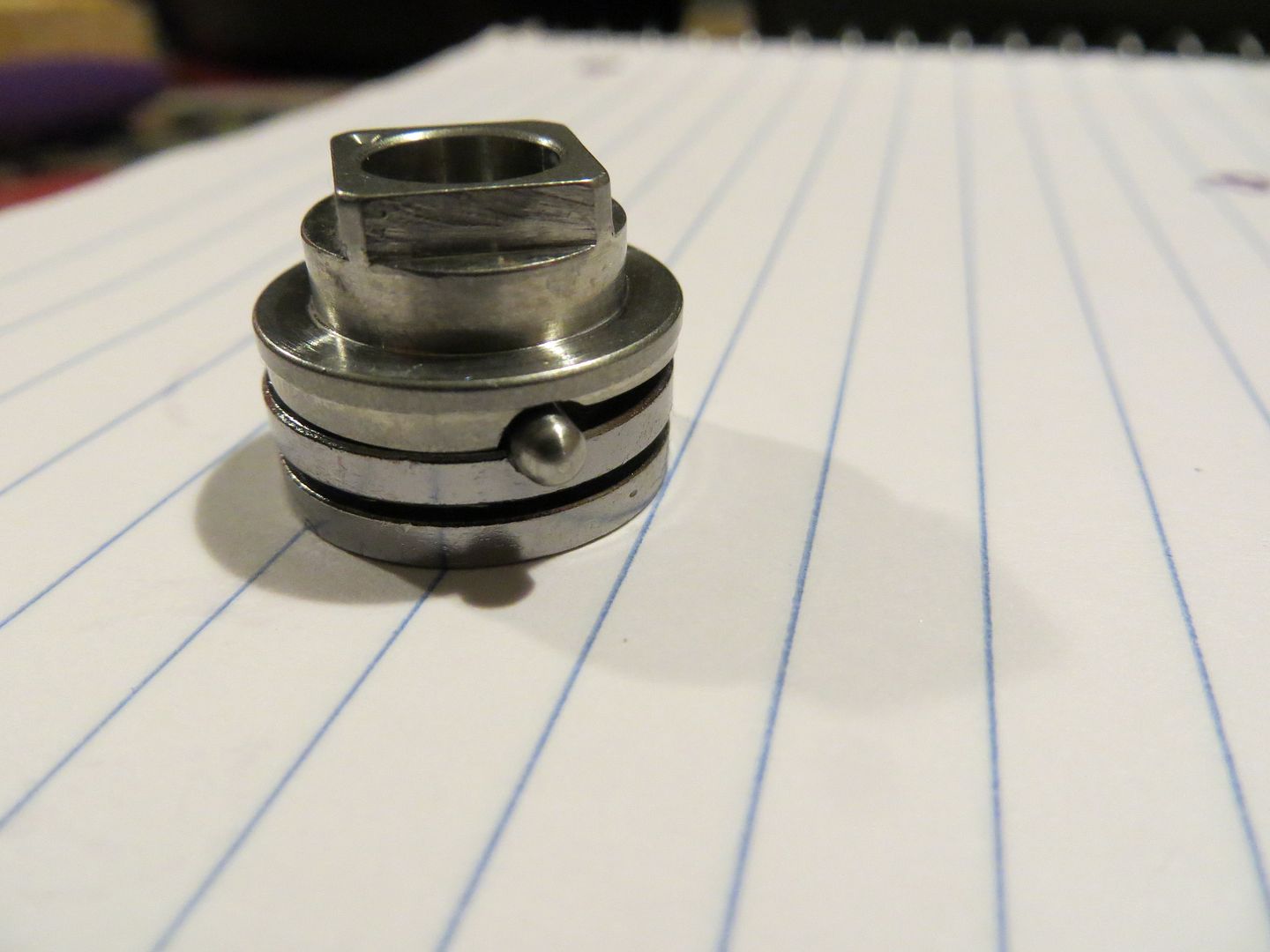

   This  is the final take of the drag lever as it was described.
and the cam with the notch as finished and tested.
this is the factory drag washer.  shiny and hard.   what material is it?    I dunno?    not good.
This is a new carbon fiber washer that replaces the old hard one.   works great....
   the new carbon fiber one is .015'' inch thicker.
heres how i made the new one.  was quite easy.  clamped the fiber sheet between the wood and drilled thru  slowly.
 the old washer was the pattern for the hole placement.
snips cut the rough out and final filing and grinding made it round to fit.
   again the finished product works great,  greased and smooth.  waaay better,  with 30# max and fair freespool.  After rearranging the bellevelles and adding one more,  from a penn 16s,  fit fine and just happened to have a couple spares.
