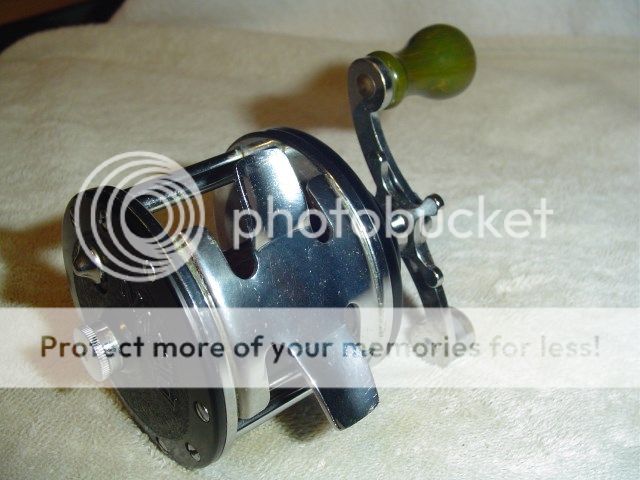

About your Penn 180, it is most definitely a pre-war Penn 180; but, it is not a first year model. The tail plate is incorrect, it should have trim ring cut. Your tail plate is from a Model 170 or 190. The handle knob on your 180 is a match to the one used on the first 109, which would be a 1942 model. I would feel that your reel is a 1942, Penn 180 / 170 / 190.
Here is a first year, Model 180. You can compare this reel to the one in the 1939 catalog or in my book, whichever one you have:
The stands of the first 180's were bent for mounting on Freshwater bait casting rods, hence the bent and short stand legs.

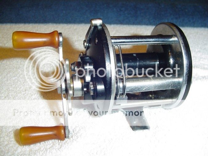

Here is a Penn 109 from its first intro year of 1942. These handle knobs match the knob on your reel.

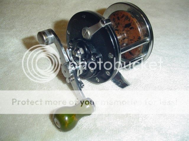

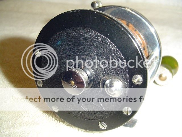

Saw this and got inspired. I have a 180 covered in corrosion but could see part of an aluminum spool. Took it apart and found the inside looking like new except for some dried grease. There are ht100 washers that looked like new. I had a decent set of bars base and handle to use and I did what I could with the rings. I didn't take a before pic but the bars and base are next to the reel. Spins well drags smooth and it's ready to go!  Thanks for the tutorial another tool for the Arsenal
