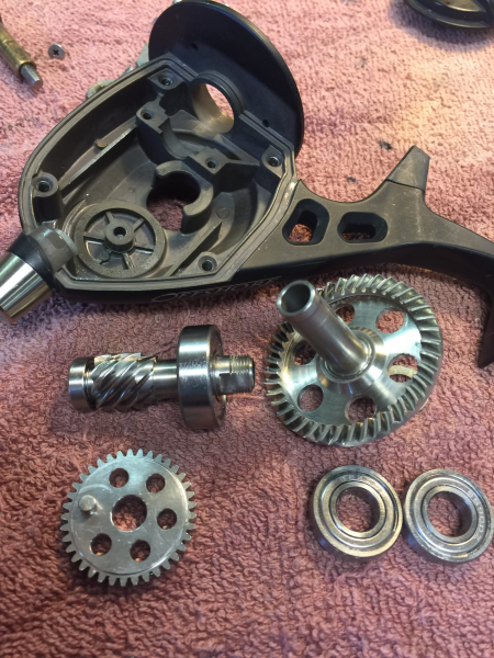

Here are some pictures of a Fin Nor spinner I serviced a few months ago. I don't remember the model but do remember the internals.
Nasty Wendy
Quote from: handi2 on April 17, 2016, 05:59:23 PM
I just wish I knew if what I'm looking at in that picture is good or bad.  LOL
