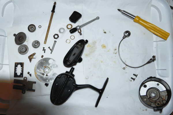

A few weeks ago I got my hands on a batch of Mitchell 300s for $3 apiece.  I set this one aside to service it, got really attached because it's a 1953 model, same year l was born, SN 50109.
It felt pretty smooth before l tore into it except the bail was pretty weak.  After disassembling it l could tell it had been taken care of, still had blue grease in it from being serviced recently with very little grime except inside the rotor.
Can't wait to see it in one piece. With a fish on the end of the line!

festus
I placed the gears, drive shaft, sliding pieces, washers, shims, and screws plus the pieces inside the rotor and bail assembly in charcoal lighter fluid for about an hour, then scrubbed clean with a toothbrush followed by a good soaking in a Dawn dishwashing detergent solution for a while, then rinsed with hot water and blew them dry with a blow dryer. Cleaned the housing and side plate with carbeuretor cleaner then scrubbed them good too.

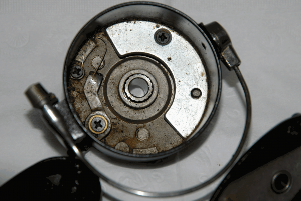

The rotor was fairly dirty, the counterweight was frozen,  I did my best cleaning it with a toothbrush and just left the counterweight as is.
