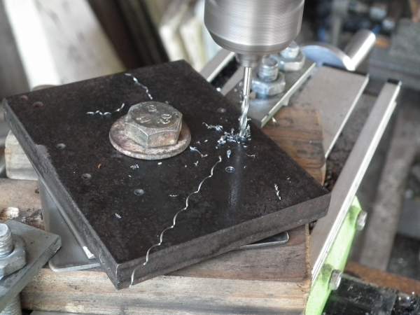

I started with a template of the squidder side plate hole locations so I could use Pro Callenger 146 spacers (or maybe a tib or accurate 146 frame later).
Marked the spacers and ring plates out;
Then used the template to drill the frame holes in the spacers and 'rings'
