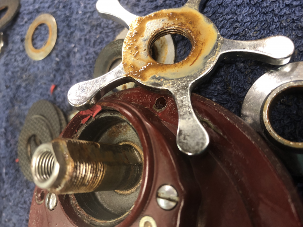

Most gear sleeves round off because the handle nut it loose or the handle used doesn't fit tight.

Like posted above the only time a stock gear sleeve gets stripped its from a loose handle nut or a loose fitting handle. Hopefully someone else that has seen one strip will chime in.
