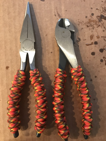

I just received a beautiful pair of wrapped cutters and pliers and need to know how to prevent them from rusting?
The pliers showed signs of rust after one day of use on the boat.....
Thanks
Pj
