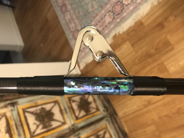

I have slowly been working on a Sabre Stroker SM80 blank.
No need for this rod in the Tampa Bay, but honestly, how many of y'all buy/build/repair things just because you're addicted?
I'm going full AFTCO roller on this build, and i've always wanted to use abalone for decorative purposes. This first product I bought was a cheap sticker of what looked like a color photocopy of a sheet of abalone. I gave it a try, and covered it in epoxy. Turned out exactly like a photocopy of abalone covered in epoxy. Go figure.
The second attempt was with genuine abalone. It is brittle but beautiful. Using a heat gun makes it wrap around the blank without cracking/separating/etc. it is stunningly beautiful.
Thought I would share my little project.
Very nice work! I bet you have a pretty blue reel like a Californian that will match that perfectly...Tip: especially on guides with heavier guage frames, dress ends with a file so you get a tapered ramp to wind on. Having a step on the big roller guides is maddening to wind on and throws off the lay, as you no doubt found. If you choose to do that, make sure the guide is underwrapped AND make sure to dress the underside to remove any burs that might get in that nice blank. I use emory cloth after filing. Also will help reducing a sag point in the epoxy. My 0.02.
ReelFishingProblems
I did that on cheaper guides, but felt weird about doing that to these. I did under wraps, but now that you pointed it out, I probably will unwrap and file the feet. It is maddening getting the guide to climb without messing up. I taped it down as tight as I could. Even then had a 3-thread width portion of the guide showing, so I pushed it down to cover. Made the rest of the winds more labor intensive since the thread wasn't straight anymore.... amazing how laziness breeds more work
I use a disk sander in a drill with 100 grit disks to taper the feet,crude but effective. Also make sure the feet are flat and straight,might have to bend them a little.

oh yeah, forgot you have a dremel, as Swami pointed out, drum sander in dremel is a lot faster.

The best tool that I found for prep work on guide feet is the Stay Sharp mini belt sander. Works great.
Dwight
I also use the stay sharp, and the best I have found so far.................Joe
