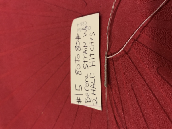

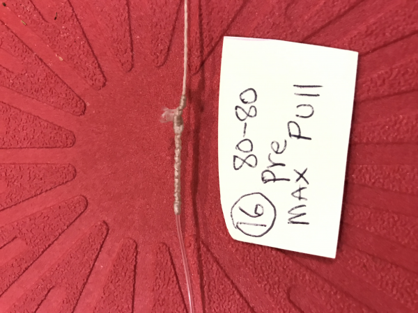

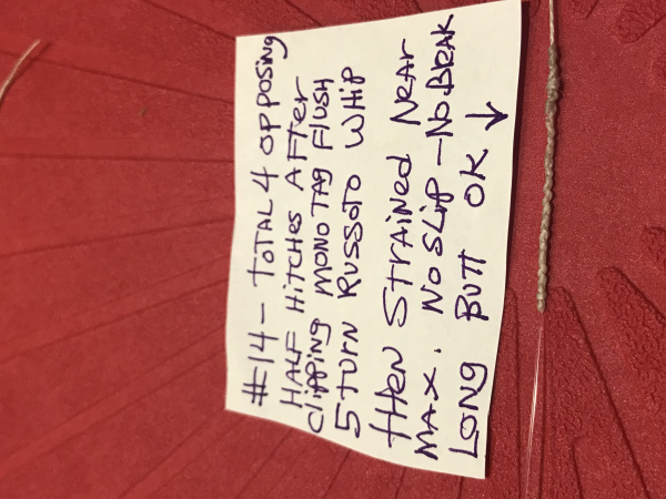

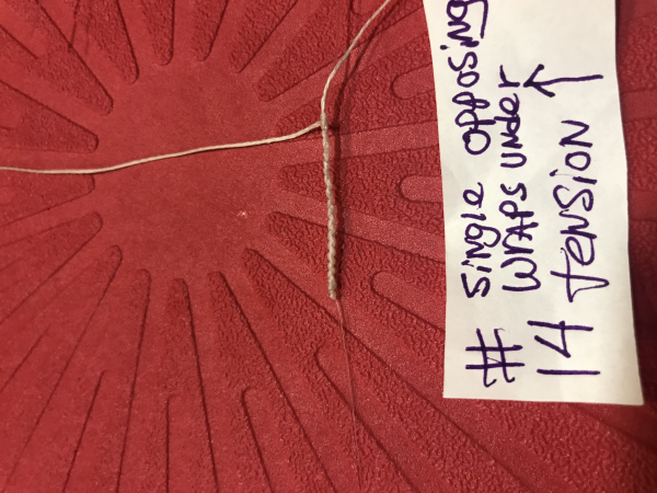

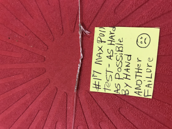

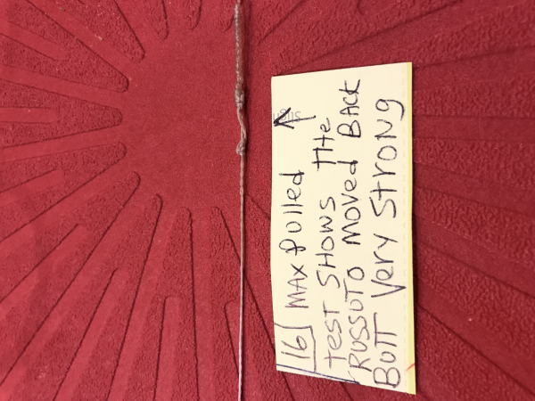

THe knot fails the max pull test.  Looks good at first?
These are from my recent pictures files.   I am going to shorten the wrapping to see if this helps .... these are tied with tension,  larger line seems easier .
Thanks again for everyone helping.  I'm not confident yet as I cannot pull that hard by hand 🖐.  Max pull is using both knees to help spread the knot.  With heavy gloves 🧤 on.   Later I will use a mechanical help

If a half hitch or two slip off the tag end, that can be survived. If any of the wraps come off the knot will pull apart. I note that your wraps are coming apart before the knot breaks - when I pop an FG out fishing, the braid breaks just above the knot.

Looking at your pictures, I'm not so sure your doing things in the right order.
After you finish however many wraps you are doing, are you pinching both lines so they don't move while you tie the first half hitch? This is important. The wraps must be tight against each other and when you finish the last wrap, pinch both lines so nothing moves. Then tie your first half hitch tight against the FG. At this point you can let it all go because the FG is locked in by that half hitch. Tighten that hitch, then grab your tool, glove or whatever your using and pull both lines tight. This is the pull that tightens the knot! This is the point when I see some minor stretch in the FG. After that, tie your other half hitches and rizzuto to finish.
After that first half hitch is tied and you go to pull tight on both lines, that knot should be tight and locked in! Like I said, I've seen very minor stretch of the knot after that step. When it's all done and you go to test the knot by pulling on it again, it shouldn't go anywhere or lengthen like in your pics because you have already pulled both lines tight.
If your not pulling the knot tight after that first half hitch, the FG is not locked in and that is what looks like is happening with your knots. Your pulling tight after your half hitches and rizzuto finish. There should be two pulls if your testing the knot. One after the first half hitch and one when it's all done which demonstrates a fish on.
Get yourself some type of dowel to pull the lines tight. It's a very effective tool that IMO is needed to get this knot tight.
