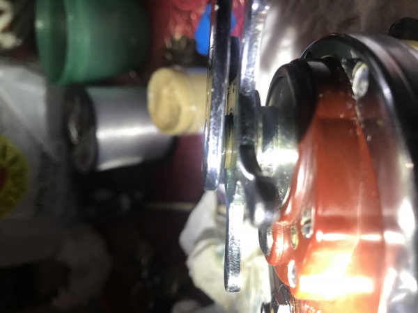

I am halfway through it, so I think what I need for this is the stainless steel parts as what I have now has brass. BTW is the handle not supposed to go down all the way or am I missing a washer?

By the looks of the top hat your drag stack is to short. What is that washer under the handle? It looks like you have a double bellville washer setup under the handle. Disassemble the handle & washers in order so we can see exactly what you have there. Lay them out in the order of disassembly.       Rudy

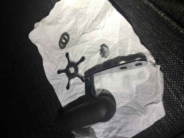

Here it is laid out.

What is under the star wheel? It should be a thick bellville washer. Toss one or both of the thin bellvilles. In between the star wheel & top hat doesn't look right. The top hat also is setting to low. You probably need an extra keyed washer on top of the drag stack.

Those two washers were underneath the star drag. Hmm, so there are parts missing. Time to source them.  Is this use able as is or should I just wait?

If it seems to be working then use it but turn down the star wheel so you can tighten down the handle all the way. Then back off the star against the handle. The correct order of assembly starting from the handle screw is ---- handle screw, handle, one or no thin bellville washer, star wheel, one thick bellville washer, then top hat. Upper edge of top hat should be very slightly above the hole in the plate with the drag backed off.
