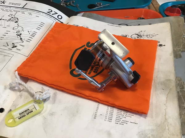

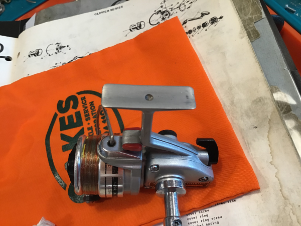

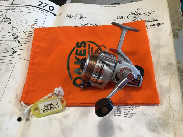

This reel is probably too heavy nowadays to be considered ultralight, weighs 9.4 oz and has line capacities of 6/160 yd and 8/110 yd.  If this reel was manufactured today with graphite body, spool, and other non-metal components, yep, it would be ultralight.
This reel was VERY stiff straight out of the mailing box, so stiff, I refrained from turning the handle thinking maybe something inside would break.
This reel has the loop type oscillating slider.
Inside the housing wasn't that dirty.
We found the culprit, the old dried grease on the main gear had almost turned to stone.
As in many other economy model Daiwas from this time frame, this one didn't have the nut and lockwasher type fasteners for the rotor.  We have this type of pinion retainer.
Other than the pinion and main gear, nothing else was that dirty, so clean up was easy.
Using Superlube grease again, it's getting to be my favorite.
A major oil spill, lol, I only use one drop on the axle.
I definitely got my money's worth with this one, shipping cost more than the reel, totaled less than 14 bucks.
