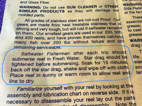

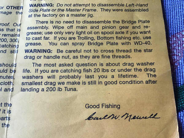

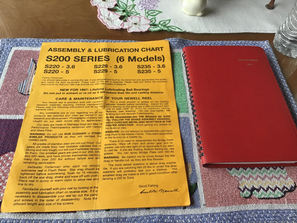

This is a good question — and an easy one to overthink for us reel mechanics who are capable of completely tearing apart and lubricating a reel in short order.
I look at quality reels as tools — not Holy Grails to be pulled out once a year just to worship and look at.
A quality reel was made to work in water environments.
For me, nothing wrong with dunking a salt used reel in a bucket of fresh water for 15 or 20 minutes — I do close the drags down.  If my reel can't take that treatment, after I have properly prepped, serviced, and spooled it — it is not the reel for me.
Now, if I know I will be able to do a proper service in a day, or so — it just gets a light spray or rinse of fresh water — drags stay tightened down.
30 years ago, Carl Newell recommended that this be done when on long range trips with his reels.  Of course, his reels were mostly SS with dry drags.  With the Marine grade Yamalube, or Penn grease we use today — coupled with CF Cal's grease coated drags — it is even easier to dunk a reel for 15 minutes.
Proper prep, grease, and common sense experience are key, IMO.
The worst reels I get across the bench are ones used in the salt — Then just stored in a garage for a couple of years.
Thinking ahead, timing, trip duration, an when planned service is scheduled — are all useful when keeping your gear in top shape and always operational.
Many of the old timers have a lot of horse sense.  Many things that are useful and smart are also counter-intuitive to our more modern upbringing.  As an example, many experienced woodsmen who work the timber for a living — always store their axes in a bucket of water.  The heads may get rusty — but they will always be tight and capable when needed.
Just my opinions...
